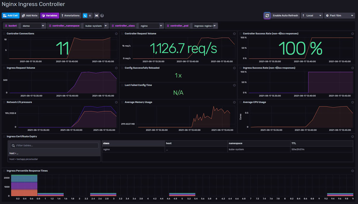

Nginx ingress Controller dashboard

Key Nginx Ingress Controller metrics to monitor
Some of the most important Nginx Ingress Controller monitoring metrics that you should proactively monitor include:
  • Controller connections
  • Controller Request volume
  • Ingress Request volume
  • Network I/O pressure
  • Config successfully reloaded
  • Last failed config time
  • Average memory usage
  • Ingress Certificate expiry
  • Ingress Percentile response time
