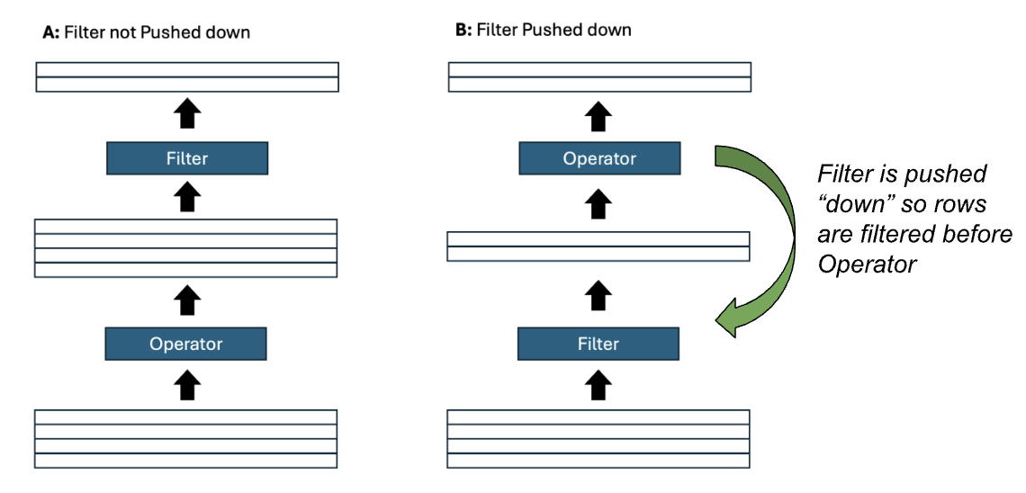

Predicate/Filter Pushdown
Why: Avoids carrying unneeded rows as soon as possible.
What: Moves filters “down” in the plan so they run earlier in execution, as shown in Figure 1.
Example Implementations: DataFusion, DuckDB, ClickHouse
The earlier data is filtered out in the plan, the less work the rest of the plan has to do. Most mature databases aggressively use filter pushdown/early filtering combined with techniques such as partition and storage pruning (e.g., Parquet Row Group pruning) for performance.
An extreme and somewhat contrived example query:
SELECT city, COUNT(*) FROM population GROUP BY city HAVING city = ‘BOSTON’;
Semantically, HAVING is evaluated after GROUP BY in SQL. However, computing the population of all cities and discarding everything except Boston is much slower than computing only the population for Boston, so most Query Optimizers will evaluate the filter before the aggregation.
Figure 1: Filter Pushdown. In (A), without filter pushdown, the operator processes more rows, reducing efficiency. In (B) with filter pushdown, the operator receives fewer rows, resulting in less overall work and a faster and more efficient query.

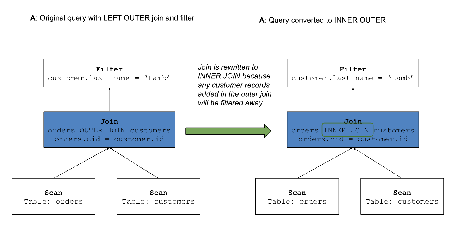

Rewriting OUTER JOIN → INNER JOIN
Why: INNER JOIN implementations are almost always faster (as they are simpler) than OUTER JOIN implementations. INNER JOINs impose fewer restrictions on other optimizer passes (such as join reordering and additional filter pushdown).
What: In cases where null rows introduced by an OUTER JOIN will not appear in the results, it can be rewritten to an INNER JOIN.
Example Implementations: DataFusion, Spark, ClickHouse.
For example, given a query such as the following:
SELECT …
FROM orders LEFT OUTER JOIN customer ON (orders.cid = customer.id)
WHERE customer.last_name = ‘Lamb’
The LEFT OUTER JOIN keeps all rows in orders that don’t have a matching customer but fills in the fields with null. All such rows will be filtered out by customer.last_name = ‘Lamb’ and thus an INNER JOIN produces the same answer. This is illustrated in Figure 4.
Figure 4: Rewriting OUTER JOIN to INNER JOIN. In (A), the original query contains an OUTER JOIN and a filter on customer.last_name, which filters out all rows that might be introduced by the OUTER JOIN. In (B), the OUTER JOIN is converted to inner join and a more efficient implementation can be used.
