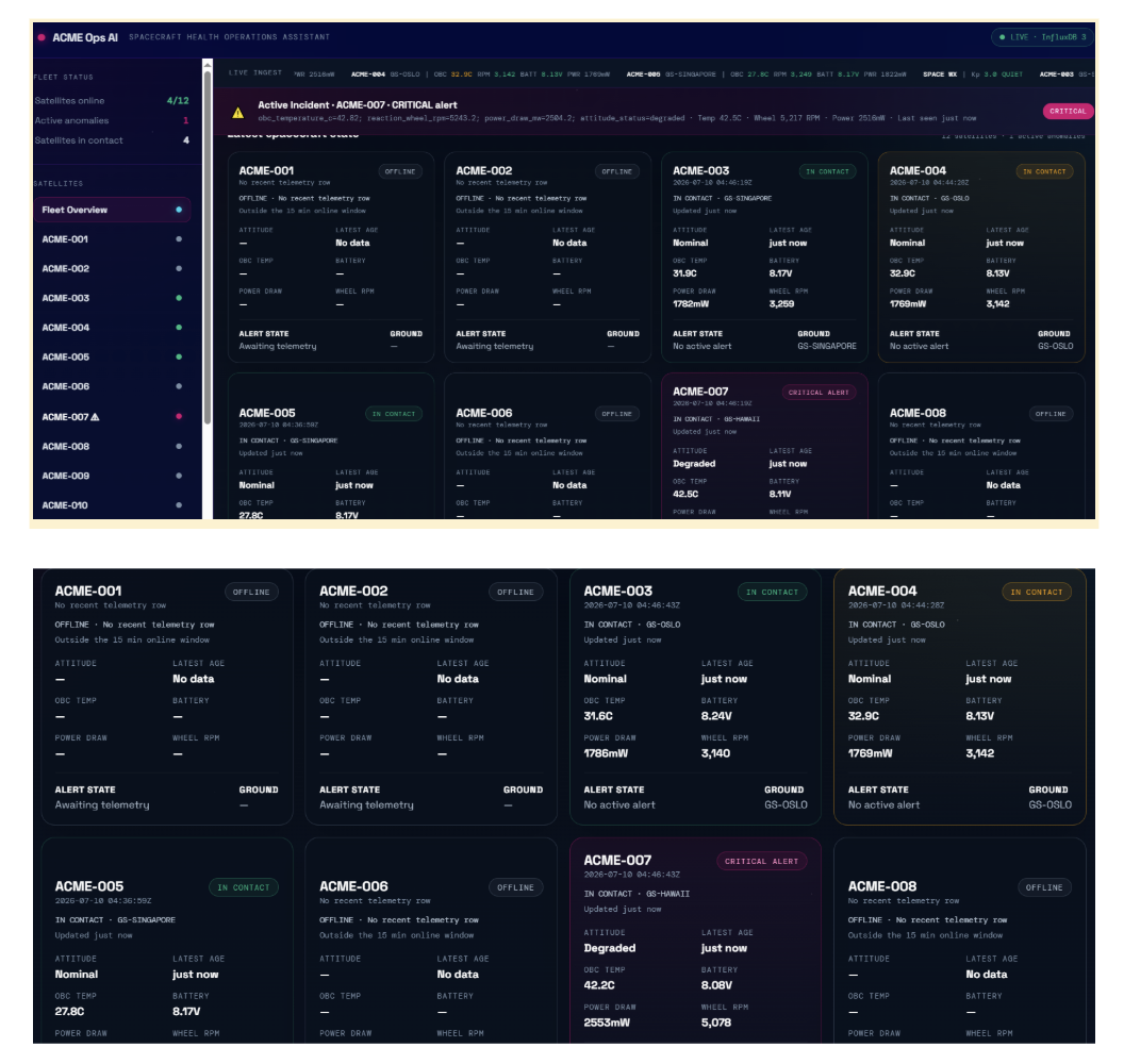

The demo monitors a simulated fleet of 12 satellites, continuously ingesting telemetry such as onboard computer temperature, battery voltage, solar current, reaction wheel RPM, power draw, RF link margin, ground station, orbit pass, and attitude status. One satellite is actively degrading, while historical incidents provide useful context for comparison.

The main dashboard provides a fleet overview showing which satellites are online, which are currently in contact, and where anomalies are occurring. Operators can then drill into individual spacecraft to get a more specific view and look at historical data.

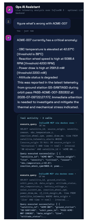

This demo also includes an AI agent powered by the InfluxDB 3 MCP server. Instead of generating answers based on generic knowledge, the agent can access data stored in InfluxDB. You can ask about fleet health, a specific satellite, or the root cause of a suspected issue. The agent can then query InfluxDB throughout a conversation and summarize what it found.

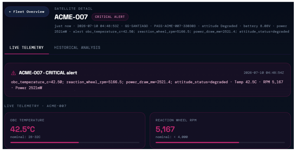

Alerting on Real-Time Data
Each incoming batch of satellite telemetry data triggers a processing engine plugin that evaluates data, such as:
  • Onboard computer temperature
  • Reaction wheel RPMs
  • Power draw
  • Attitude status
If an anomaly is found, an alert is written to a separate InfluxDB table. The row contains all relevant information for managing an incident, both in the short term and for historical tracking. Instead of the AI agent burning tokens querying and searching raw telemetry, it works from a dedicated alert stream that preserves the signal behind the alert.

The AI agent is connected to InfluxDB via the MCP server. Rather than relying on a static prompt or blindly summarizing a dashboard, it can query recent telemetry and alerts, inspect the result, and explain its conclusion.
The UI exposes that query/tool trace so operators can see what evidence informed the answer. The agent effectively becomes an interface to your data model.

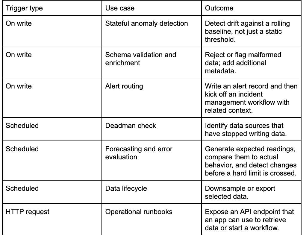

InfluxDB 3’s Processing Engine runs Python inside the database and supports triggers on data writes, schedules, and HTTP requests. That allows it to do far more than simple threshold alerts. You can check the documentation for more detail on the three trigger types and how plugins can retain state between executions.
Here are a few interesting ways you can take advantage of the Processing Engine:
Trigger type Use case Outcome
On write Stateful anomaly detection Detect drift against a rolling baseline, not just a static threshold.
On write Schema validation and enrichment Reject or flag malformed data; add additional metadata.
On write Alert routing Write an alert record and then kick off an incident management workflow with related context.
Scheduled Deadman check Identify data sources that have stopped writing data.
Scheduled Forecasting and error evaluation Generate expected readings, compare them to actual behavior, and detect changes before a hard limit is crossed.
Scheduled Data lifecycle Downsample or export selected data.
HTTP request Operational runbooks Expose an API endpoint that an app can use to retrieve data or start a workflow.
