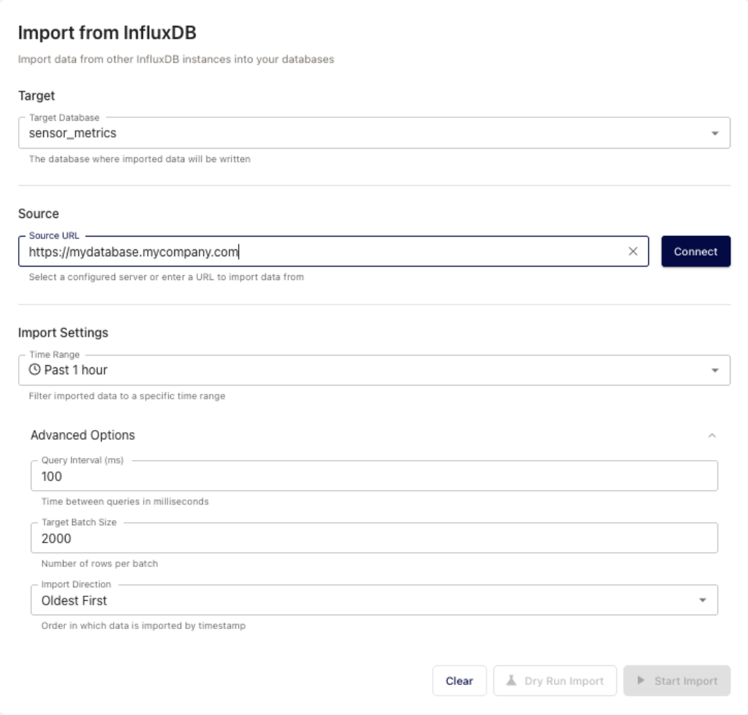

This is what it looks like for the Import plugin:
Import plugin SS

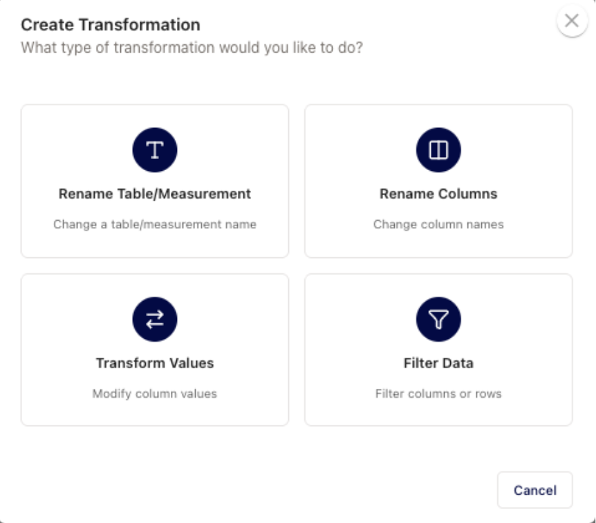

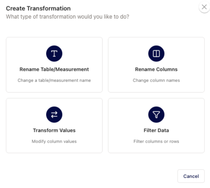

This is what the Basic Transformation and Downsample configuration looks like:
Basic Transformation SS
Downsample SS
