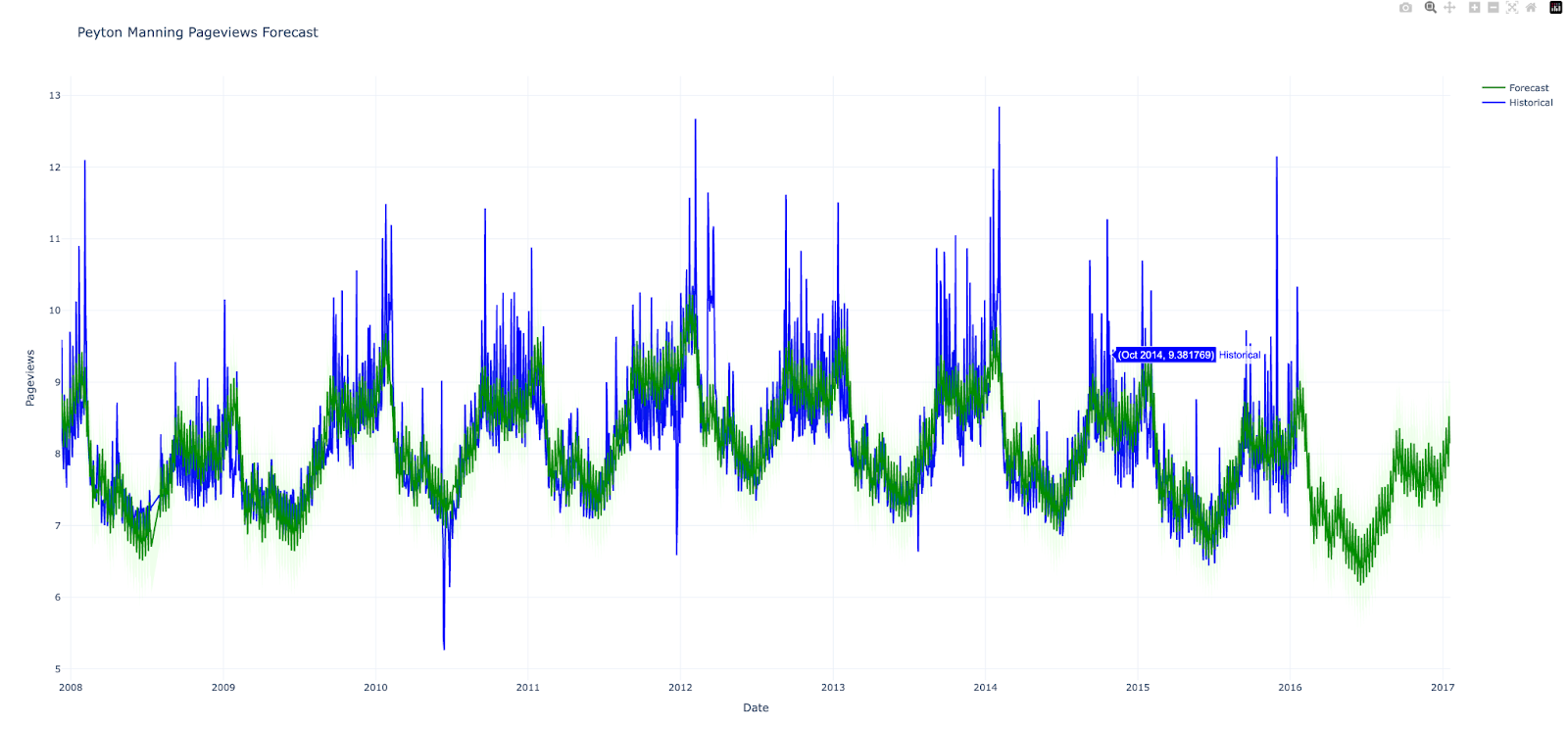

Now, let’s build a pipeline that predicts daily pageviews for the Wikipedia article on Peyton Manning over an entire year, starting with historical data and ending with an interactive Plotly visualization. To build alongside this project, download InfluxDB 3 Core or Enterprise. This project will cover:

A visualization of the historical page view data (blue) and forecasted page view data (green) that you can generate by following this tutorial. Accessible by visiting http://localhost:8181/api/v3/engine/plot_forecast.

Visit http://localhost:8181/api/v3/engine/plot_forecast to view the historical data and forecast shared in the first section of this tutorial.
