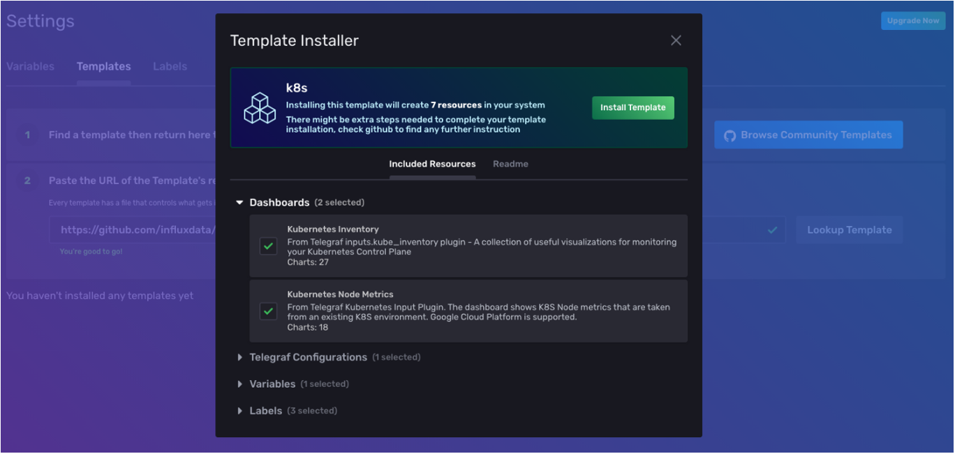

InfluxDB Templates available in the user interface
You can now harness the power of the community using InfluxDB Templates directly in your browser. InfluxDB Templates are a great way to import pre-configured dashboards, tasks, and alerts for popular technology like Docker or Kubernetes. This allows you to install any of the more than 40 templates from our Community Templates repository or add your own.
