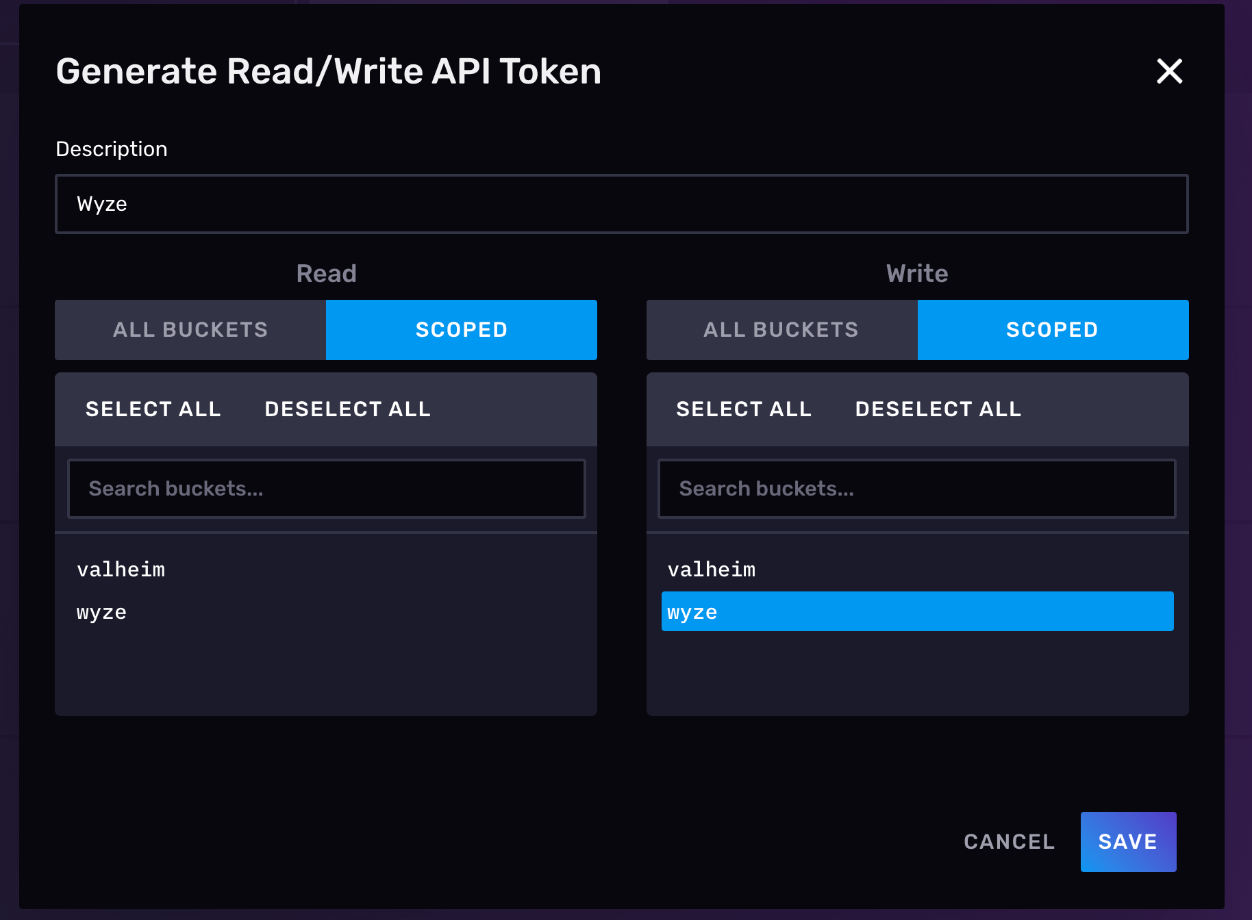

While you’re on this page, click the “API Tokens” tab. Create a new “read/write” token with write permissions to your newly created bucket. This token will give IFTTT permission to write to your InfluxDB bucket.
After you’ve created your new token, copy that token to your clipboard.

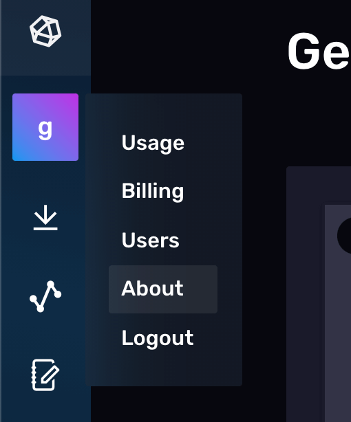

Finally, you’ll need to find your InfluxDB Organization ID. Click the initial icon on the nav bar and select About.
You’ll find your Organization ID on this page. Copy that somewhere as well, so you can reference it later.

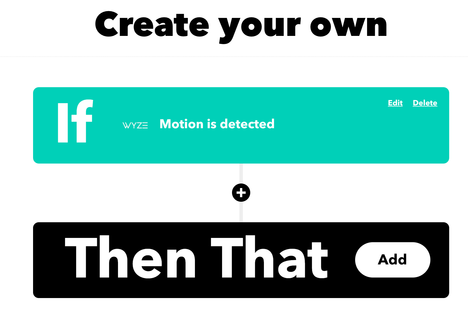

Click the Create button in the top right corner. You’ll then be presented with the “If this…”, “…then that” screen.
Click “If this…” and then search for the Wyze service.
You’ll be presented with events you can subscribe to. In our case, we’re interested in the motion events from the cameras.
Select Motion detected and then choose Any camera in the dropdown.
After clicking Create Trigger, you should see this screen. This means half your job is done!
And now, you guessed it, click the …Then that button!

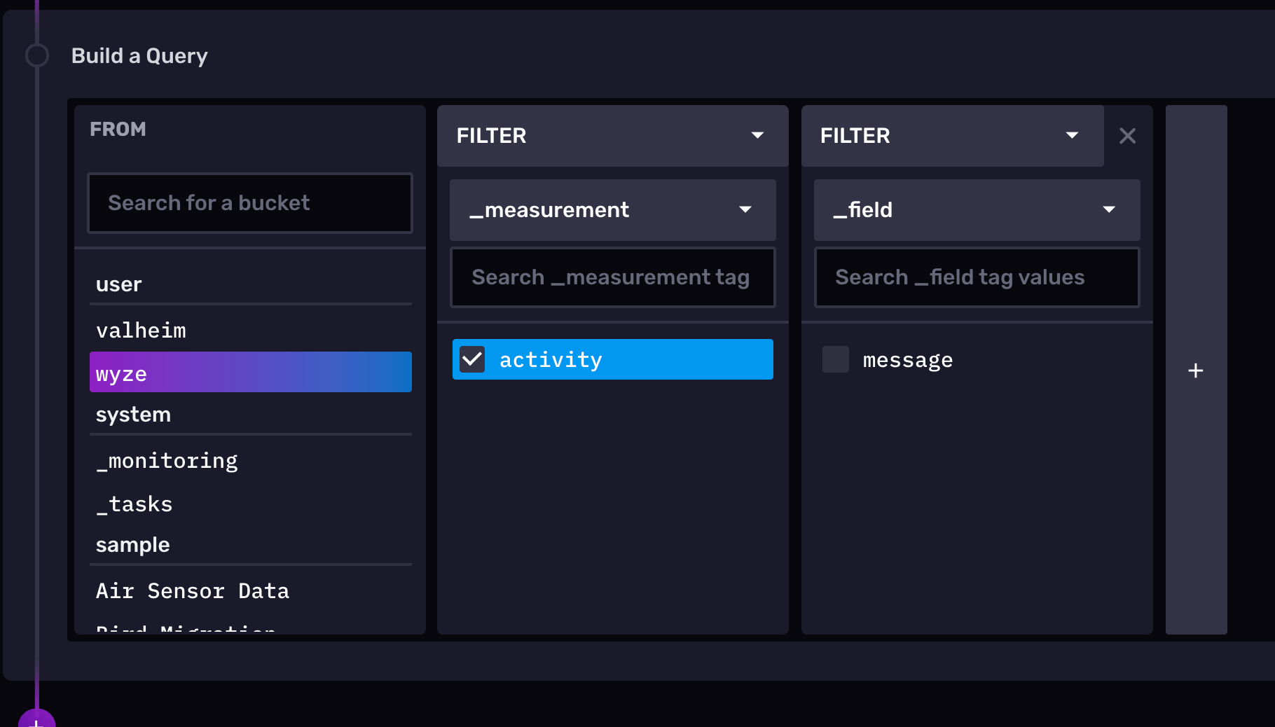

Select your bucket and the measurement “activity” in the query builder.

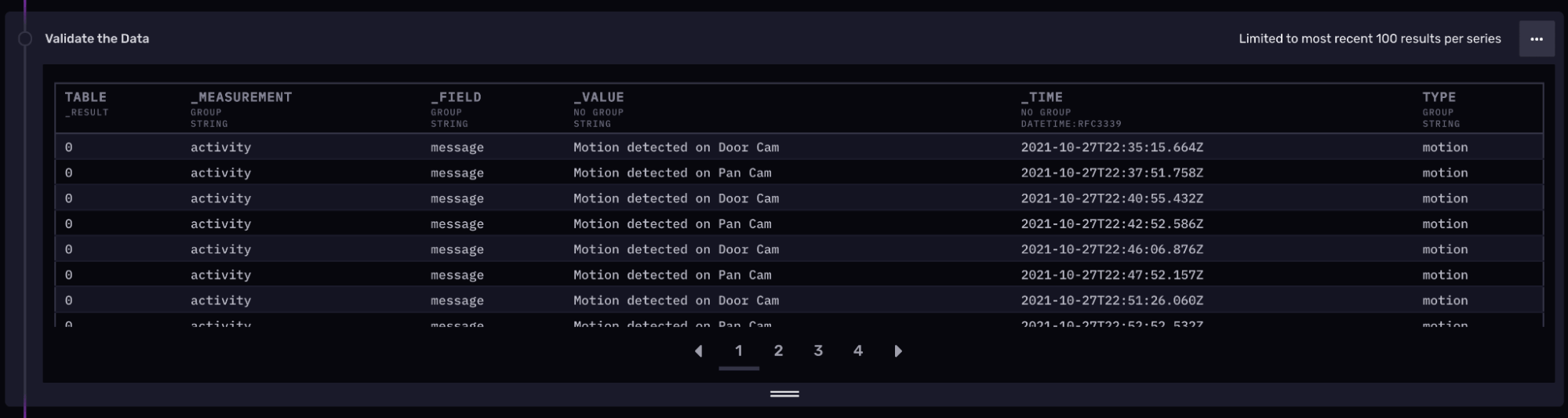

Next, click the Run button at the top of the Notebook to run the query.
You should see some data.

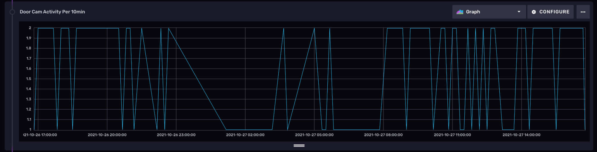

If you don’t, make sure to check your time window at the top right of the Notebook — I have mine set to “Past 24 hours”. My visualization looks like this:

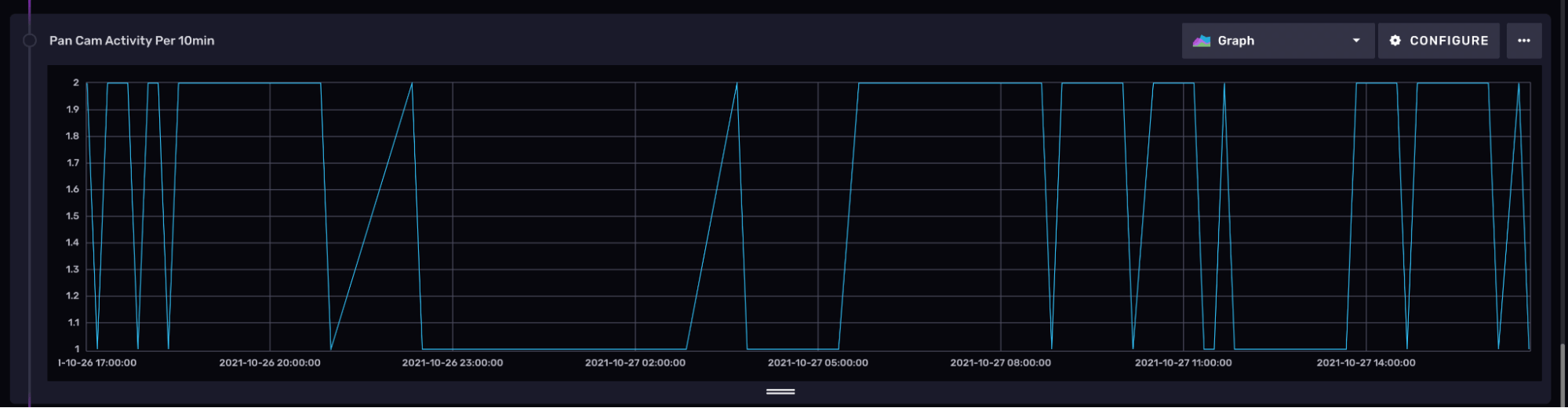

The Door Cam sees at most two motion events every 10 minutes. If I repeat the same process and produce another visualization for the Pan Cam, it looks very similar. It seems more often than not, both cameras detect the same events. I should probably check to make sure there isn’t any overlap in their visible field.
