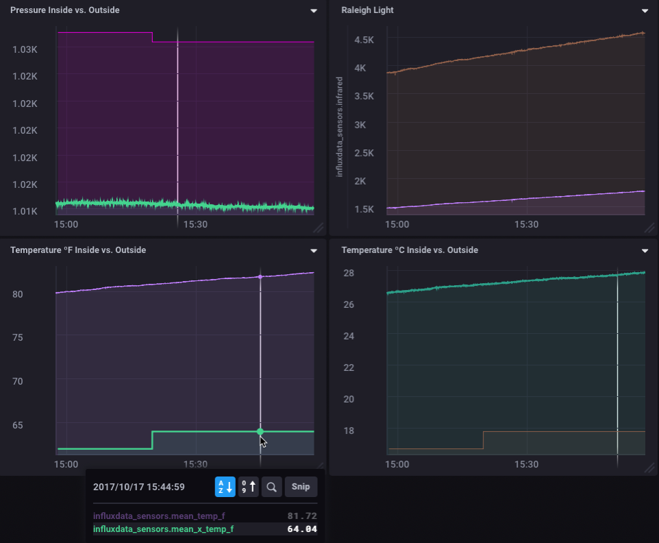

See? Really simple! So far I’m only collecting external data from 4 observation stations, and correlating it via tags in the database, with the existing sensors. And now I have a new dashboard where I can see the differential between the real-time data coming off my sensor (which is indoors) and the observed data from the NWS which I presume is outdoors.
It’s pretty plain to see that my Air Conditioner is broken. I have to admit that I was a little surprised by the difference in atmospheric pressure though. I’m still puzzled as to how the pressure is lower in my house than it is outdoors, but it could also be simply that the observation station is a few miles away, and there is a pressure differential over that distance.
