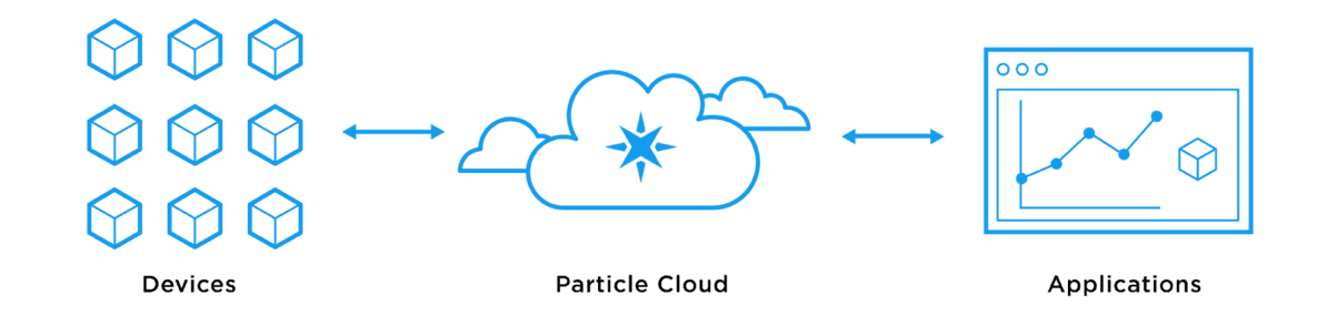

Generally, the architecture for a Particle.io IoT project is as follows:

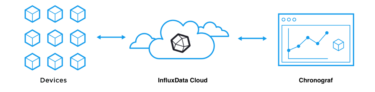

Your Particle devices speak directly to the Particle cloud, and then your applications get their data from the Particle cloud. This really wasn’t what I was looking to do since I obviously wanted to use the InfluxData stack to collect and analyze the data. So my architecture looks like this:
Yes, it looks identical. But rather than using the Particle cloud, I’m using the InfluxData Cloud to collect the data, and Chronograf to build a dashboard for visualization. Subtle, but important, difference to be sure. One of the things that it gives us is the ability to persist data, and to look at historical data, which I like. Trend analysis is important in IoT data analysis, and this gives me that very easily.

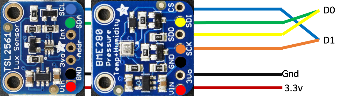

That’s the time-lapse of me building everything except the sensors. The camera malfunctioned during the sensor-build, so we lost that part. Since the sensors are both I2C-based sensors, I was able to build a simple ribbon-cable to connect everything:
As you can see, it only uses two input pins (D0 and D1), the 3.3v supply line and ground. Each of the sensors has a different I2C address by default, so they can be tied to the same pins and addressed separately. The TSL2561 actually has 3 addresses depending on if you pull it high, pull it low, or leave it floatingthe default, which is what I used since it didn’t conflict with the BME280 address.
#define TSL2561_ADDR_FLOAT (0x39)
#define BME280_ADDRESS (0x77)
All that was left was to solder the sensor rig to the Photon itself and the sensors were ready to go!

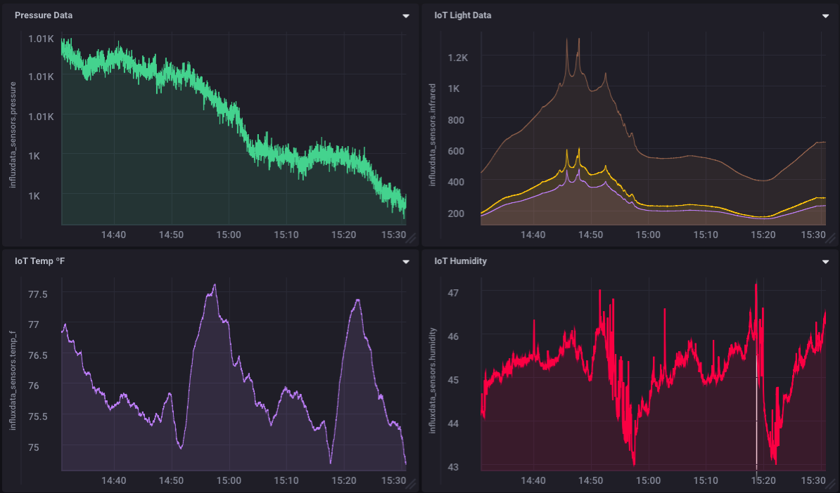

Once I had the sensor on line (I’m still shipping the others around to come online, so the data will get better, and more complex) it took all of about 3 minutes to build the dashboard so that I could see what was going on.
You’ll notice that the pressure has been steadily dropping which, correctly, indicates that a storm is approaching. The light data corroborates this as clouds were indeed moving in. As I was looking at the graphs I was a little confused by the temperature and humidity plots. Why was the temperature slowly dropping to 74º, then spiking back to 77º? As I was watching this and pondering it, my central air conditioning kicked on and I watched as the temperature and humidity dropped. So while I was not explicitly monitoring my AC unit, it turns out I can effectively monitor when it cycles on and off just by the temperature and humidity graphs on my dashboard. It’s amazing what you can discover when you can actually see your data! Are there unexpected gems hidden in your data that you’re simply not aware of because you can’t see them?
