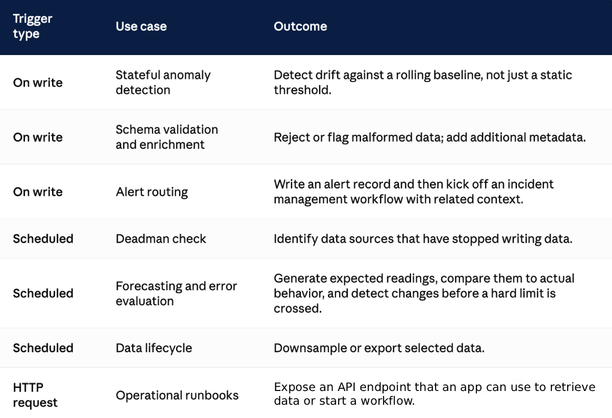

InfluxDB 3’s Processing Engine runs Python inside the database and supports triggers on data writes, schedules, and HTTP requests. That allows it to do far more than simple threshold alerts. You can check the documentation for more detail on the three trigger types and how plugins can retain state between executions.
Here are a few interesting ways you can take advantage of the Processing Engine:
| Trigger type | Use case | Outcome |
| On write | Stateful anomaly detection | Detect drift across a rolling baseline, not just a static threshold. |
| On write | Schema validation and enrichment | Reject or flag malformed data; add additional metadata. |
| On write | Alert routing | Write an alert record and then kick of an incident management workflow with related context. |
| Scheduled | Deadman check | Identify data sources that have stopped wrwiting data. |
| Scheduled | Forecasting and error evaluation | Generate expected readings, compare them to actual behavior, and detect changes before a hard limit is crossed. |
| Scheduled | Data lifecycle | Downsample or export selected data |
| HTTP request | Operational runbooks | Expose an API endpoint that an app can use to retrieve data or start a workflow. |
