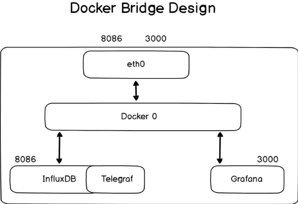

Now that Docker is ready, let’s have a quick look at the networking strategy we are going to use for our containers.
Designing the network strategy for InfluxDB
Before you begin, it is important to review a few details about networking. By default, newly created containers run on the bridge network stack. In addition, after you install InfluxDB, it will be exposed to useful ports (such as port 8086) on your network stack. Later, you can also bind Telegraf to it, but Telegraf does not have to expose any ports to your current host stack.
Let’s run InfluxDB on the default bridge network, and have Telegraf running in the same stack as InfluxDB. In addition, we will add Grafana to our bridge network in order to visualize metrics gathered by Telegraf.

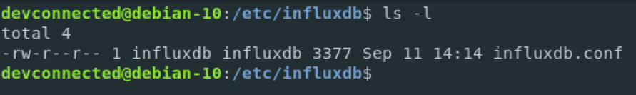

Next, reassign the folder permissions for your newly created file; otherwise, your container won’t be able to interact with it properly.
$ sudo chown influxdb:influxdb /etc/influxdb/

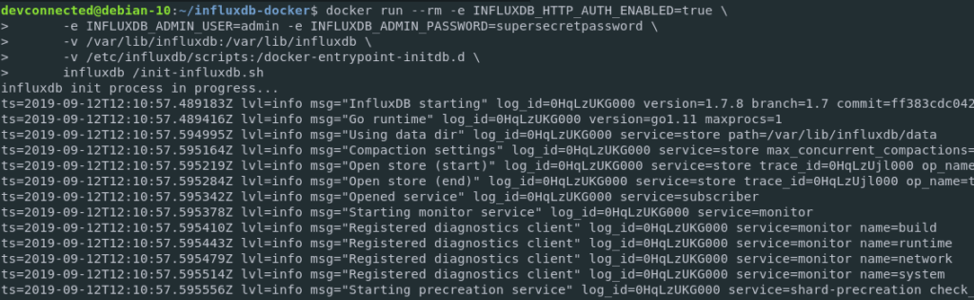

In order to update your meta database, run the following command:
$ docker run --rm -e INFLUXDB_HTTP_AUTH_ENABLED=true \
-e INFLUXDB_ADMIN_USER=admin \
-e INFLUXDB_ADMIN_PASSWORD=admin123 \
-v /var/lib/influxdb:/var/lib/influxdb \
-v /etc/influxdb/scripts:/docker-entrypoint-initdb.d \
influxdb /init-influxdb.sh
Note: Setting the INFLUXDB_HTTP_AUTH_ENABLED to true does not mean that authentication is enabled on your InfluxDB server. Authentication is enabled in one of the next sections; this parameter is only used for the initialization script.

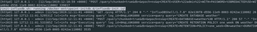

Please make sure that you have a couple of logs printed to your terminal. If this is not the case, make sure that you specified the correct environment variables for your container.
If you chose to create initialization scripts for your container, you should also have a log line for it.
As a last verification step, you can inspect your meta.db file in your meta folder to make sure that the changes were correctly written.

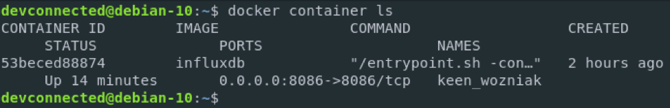

$ docker container ls
Note: If your container is not appearing here, then run this command with the -a (for all) flag to make sure that your container hasn’t crashed.
Identify the container ID of your InfluxDB container, and run the following command to have a bash in your container:
$ docker exec -it <container_id> /bin/bash
