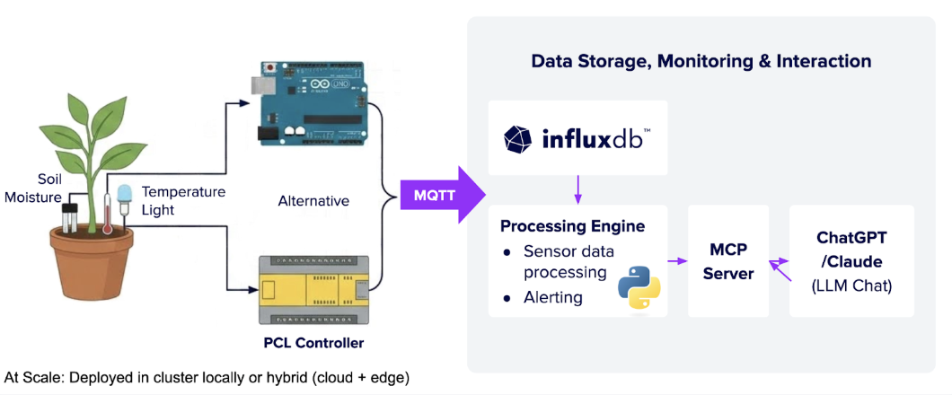

The architecture: the “factory” at home
In real factories, raw PLC data is captured at the edge, often using MQTT and a local database. That same architecture now powers PlantBuddy v3 with the following setup.
  • Edge Device (ESP32 / Arduino): Works like a small PLC. It reads soil moisture and publishes the plant’s state to the network without knowing anything about the database.
  • Soil Moisture Sensor (Analog): Outputs an analog signal based on soil moisture. The microcontroller converts it to digital using its built-in ADC.
  • Message Bus (Mosquitto MQTT): Handles publish/subscribe communication. The Arduino publishes data to the broker (running locally), and Telegraf subscribes to forward data to the database.
  • Database (InfluxDB 3 Core): Runs locally in Docker as a high-performance time series database storing all sensor readings.
  • User Interface (Claude + MCP): Enables natural language queries. Instead of writing SQL, questions about plant health can be asked conversationally.
Plant Buddy architecture

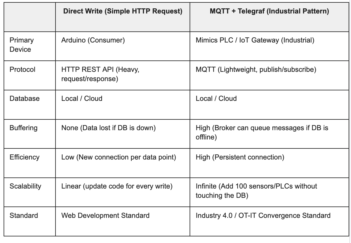

2. The Ingest Pipeline
Below are two approaches to send plant data to InfluxDB. In this project, I went with MQTT and Telegraf, which are more standard for an industrial setup.
Plant Buddy Ingest Pipeline
Telegraf acts as the gateway, subscribing to the MQTT broker and translating the JSON into InfluxDB Line Protocol. This configuration is identical to what you’d see in a manufacturing plant monitoring vibration sensors.

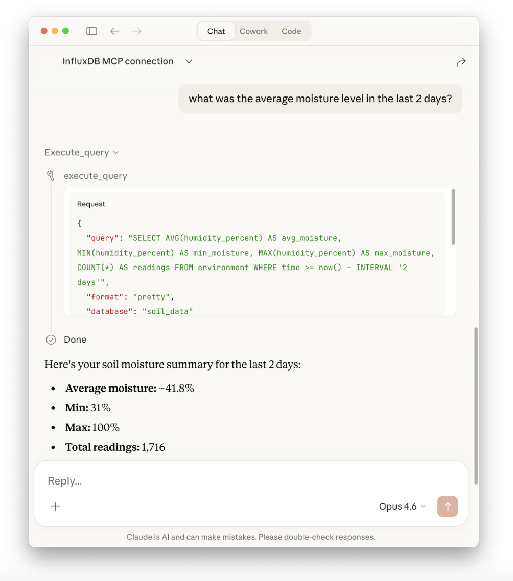

4. The “AI” Interface: InfluxDB MCP & Claude
Instead of writing SQL queries or building dashboards, the system connects an LLM to InfluxDB through the Model Context Protocol (MCP). I’ve written another blog post on how to connect InfluxDB 3 to MCP, which you can find here.
Now the question isn’t: “What’s the SQL query for average soil moisture over the last 24 hours?”
It becomes: “Has the plant been dry today?”
The LLM generates the correct SQL under the hood. If needed, the generated query can be inspected. This makes time series analytics accessible through conversation.

The Result:
Plant Buddy result
