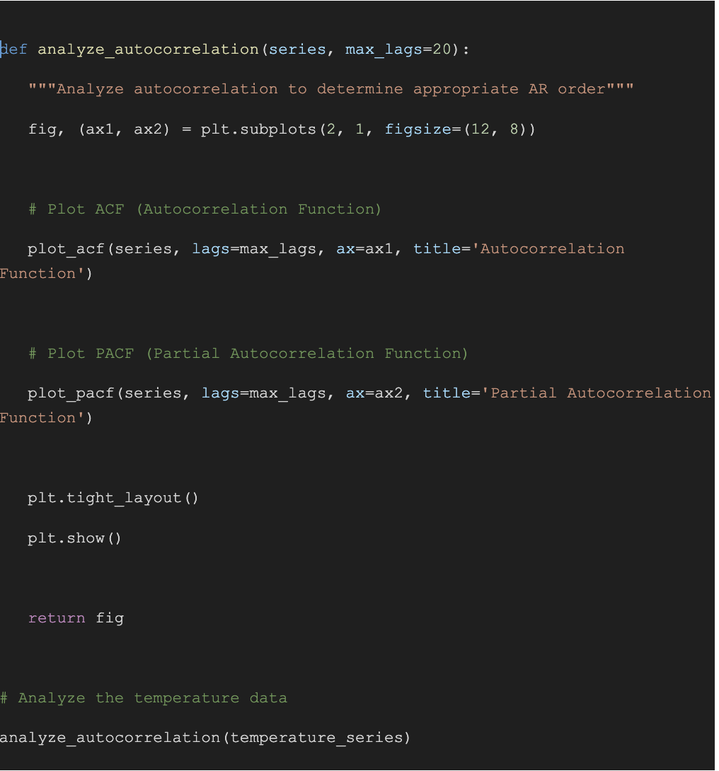

Exploring Autocorrelation and Determining Model Order
Before fitting an AR model, we need to understand the autocorrelation structure:
autocorrelation SS
The Partial Autocorrelation Function (PACF) helps determine the optimal AR order by showing the correlation between observations at different lags, controlling for shorter lags.

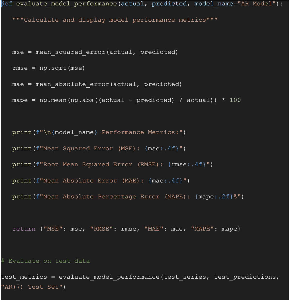

Building and Training the AR Model
Now let’s implement the autoregressive model:
AR Model SS

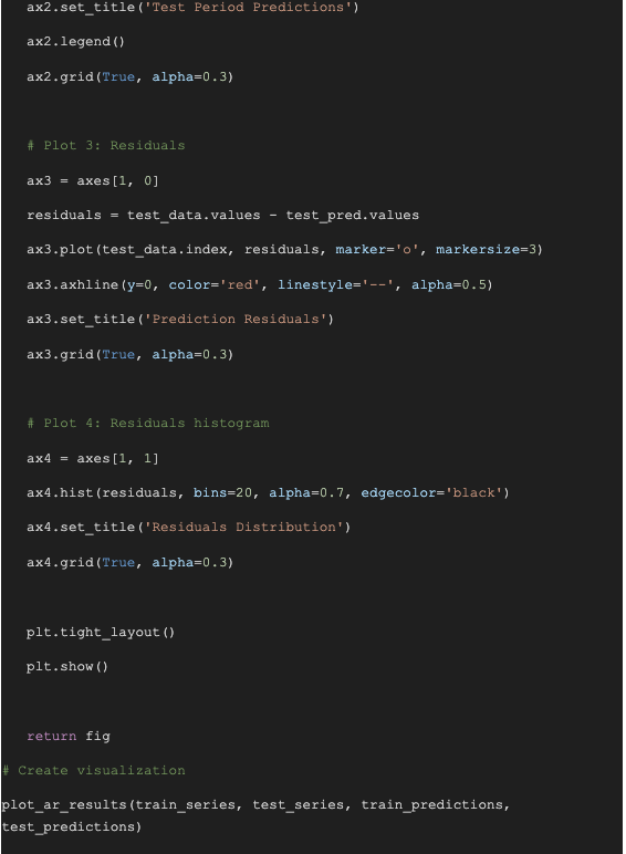

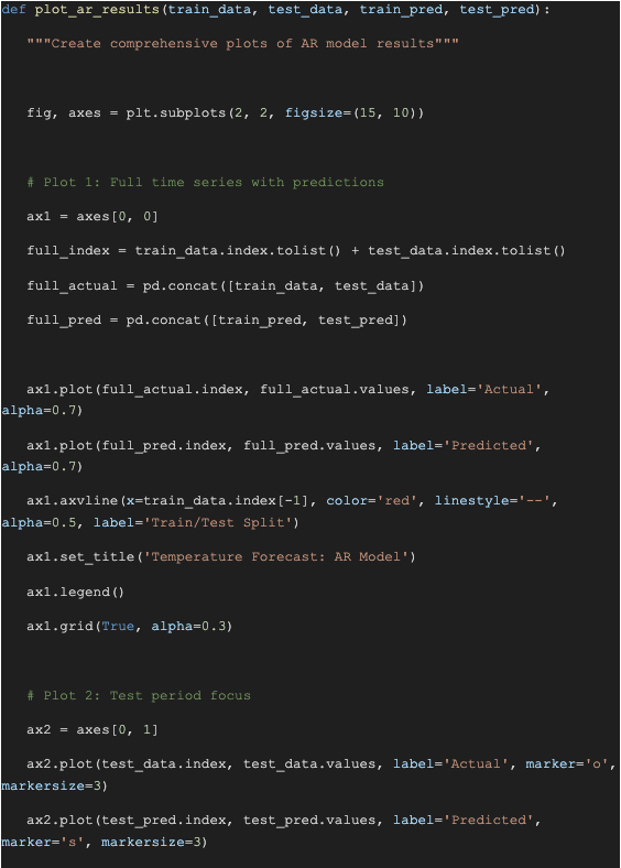

Visualization is crucial for understanding model performance:
Visualization SS 1 Visulization SS 2
