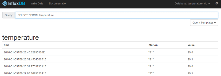

Access the admin interface from outside
We can now access the Admin interface from any machine outside the Google Compute Engine network.
You can access the Admin interface at:
http://<public-ip-influxdb-instance>:8083
To find out the public IP address that is given to your Google Compute Engine instance running InfluxDB, do the following:
- From Google Developers Console, go to sliding menu on top, Compute ? Compute Engine ? VM Instances.
- In the list of VM instances, locate the VM instance in which you are running InfluxDB. You will find that one of the columns is External IP. This is the public IP address of your Compute Engine instance.
Use that address to access the Admin interface at:
You should see an Admin interface as shown below:
Click on the drop down in the top right named Database and you should see the temperature_db database that we created as shown below:
Select the temperature_db database and fire the query to select all records as shown below:
