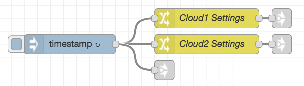

Create a new tab in Node-RED. Add the required nodes into it for configs.

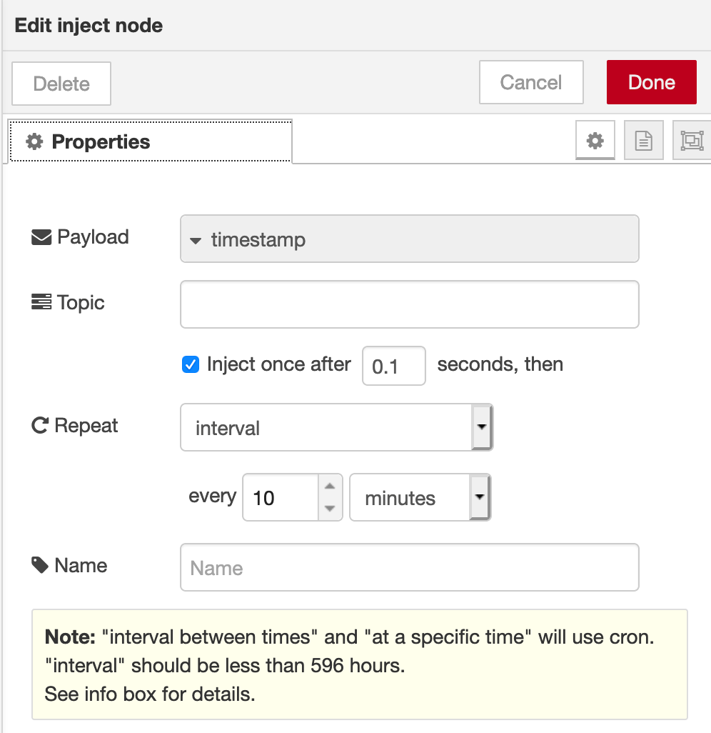

The first node, “timestamp”, updates the configs every 10 minutes.

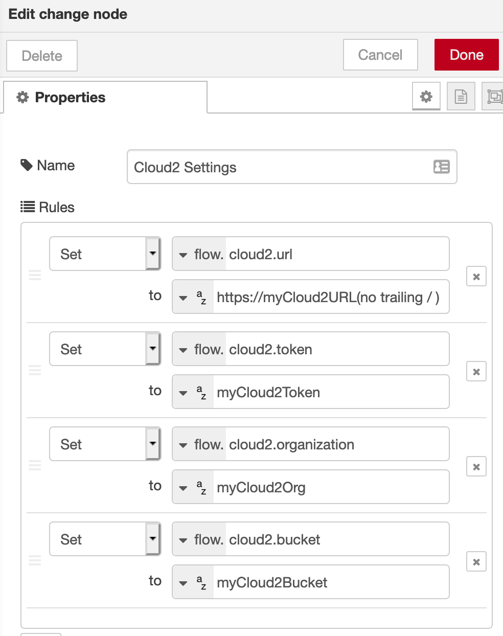

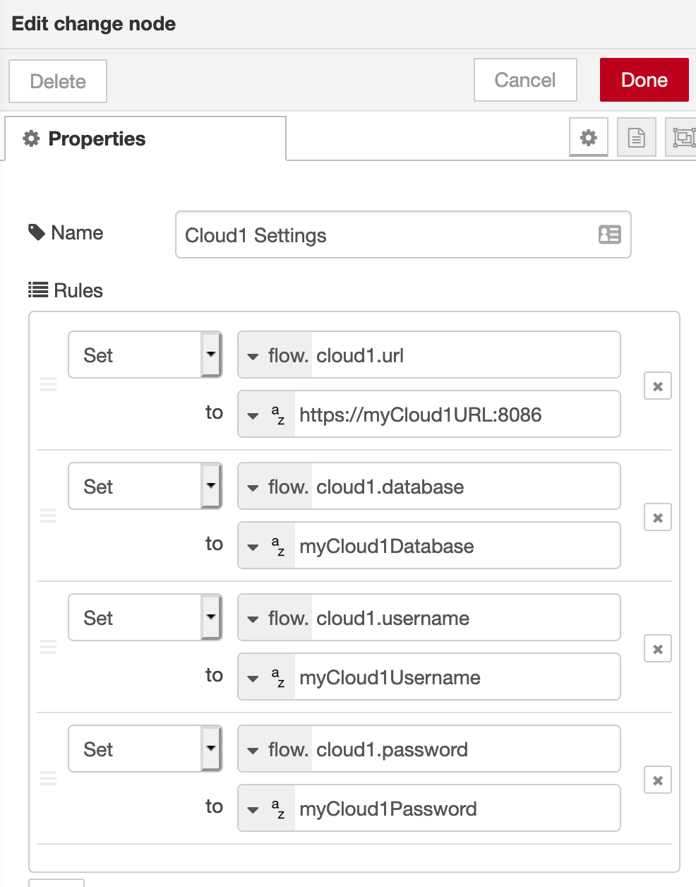

The next nodes set properties for private settings. These are “Change” nodes, and are where I’ll add all my personal information for connecting and authenticating against my Cloud instances of InfluxDB. They look like this:

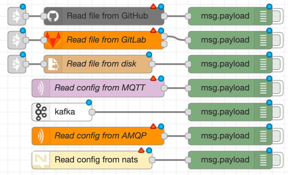

Now we need to retrieve the configs from wherever they are stored. I created nodes like this:
This is the time where you can get really creative! You might want to store your configs in GitHub or GitLab, or you might be into Software-Defined Networking (config-as-a-service) and so want to send updates over something like a messaging topic. Updated config data can come from many places, and the only difference in Node-RED is the type of node used to update the config information:

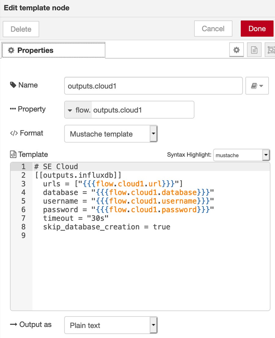

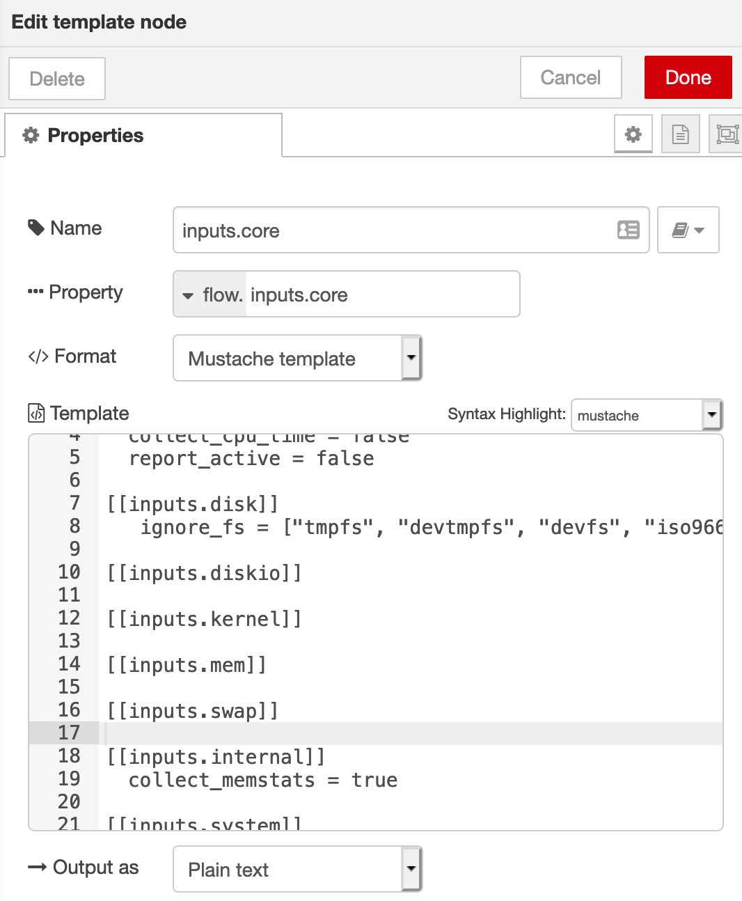

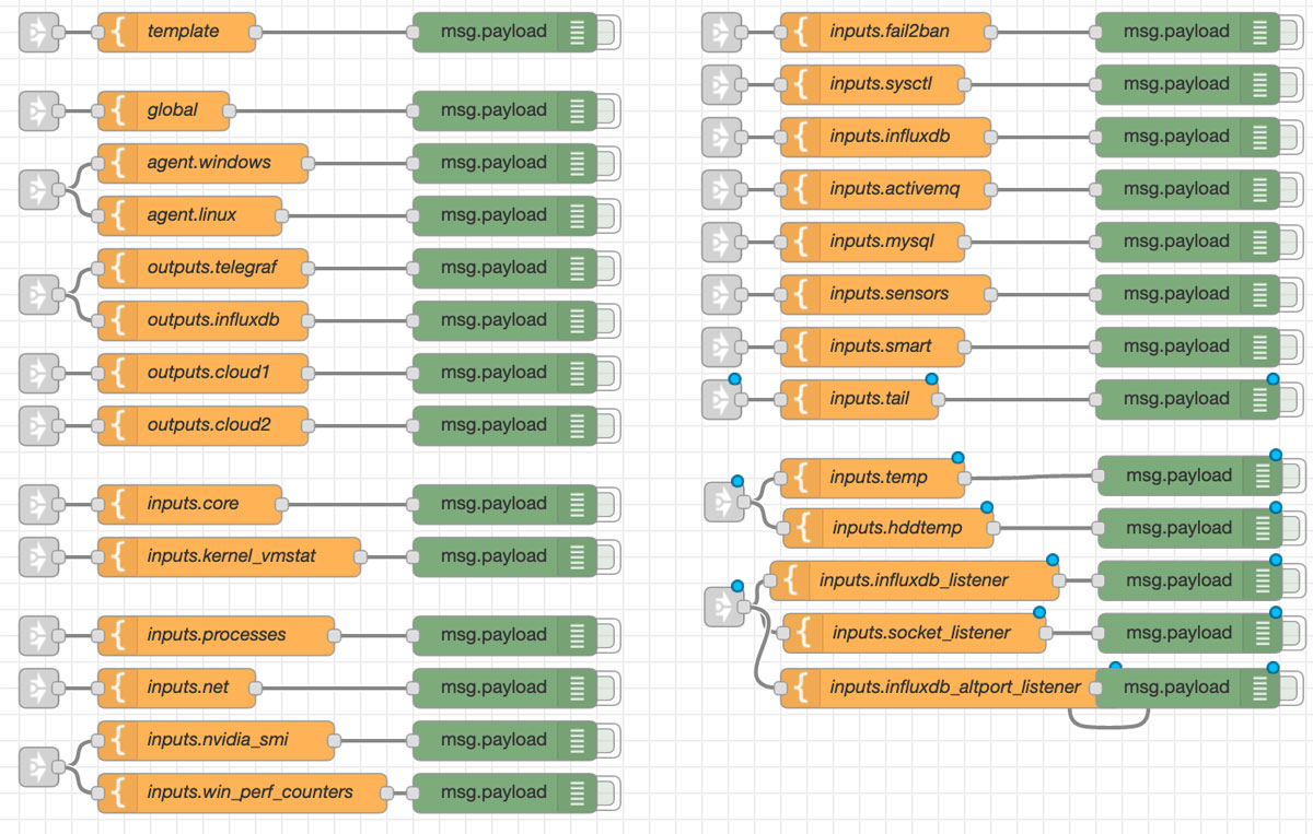

I prefer to use Node-RED to directly store my configs, so my config nodes look something like this:
Note the “mustache” template for the options urls, database, username and password. These pieces of information are retrieved from the “Change” nodes and inserted into here, so the data is always correct and current.
Multiple config snippets can exist in one template node. Create each template node as you would like, for best readability, understanding, and appropriate re-use, such as this one for a set of core monitoring inputs:

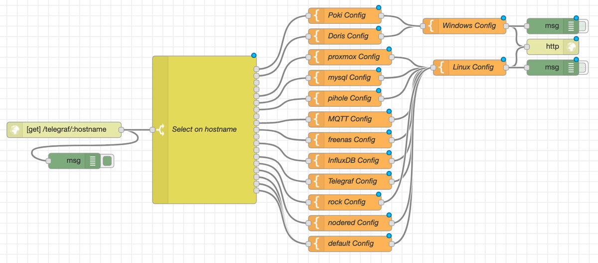

After a deployment of the flow, all of our config snippets are loaded into Node-RED, and refreshed every 10 minutes. The final task is to serve a web page for Telegraf to use:

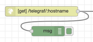

The first node in this flow is a “http-in” node. It listens for GET requests on http://192.168.1.8:1880/telegraf/:hostname.

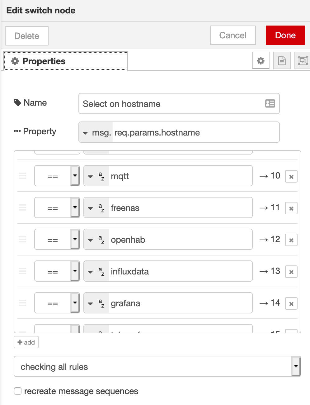

The :hostname automatically becomes a property in Node-RED, which we will use in the “Select on hostname” Switch node. Remember when we configured Telegraf with %H? That parameter replacement is what we’re using here.
The Switch node matches against the hostname, and sends the request down a specific path for each host.

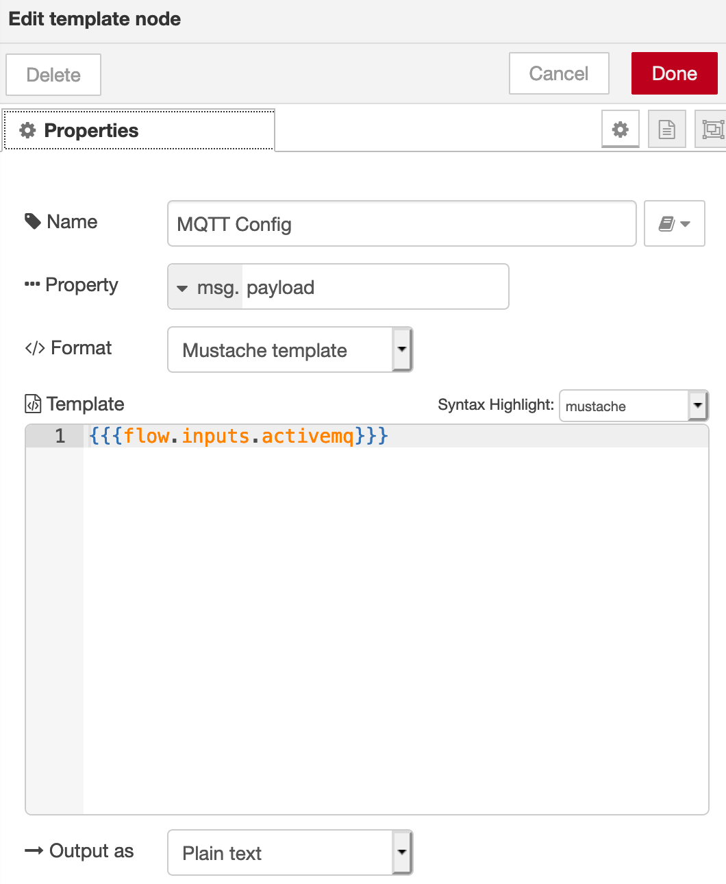

As an example to follow the workflow, let’s look at what happens for the host “mqtt”. After the Switch node selects the “mqtt” path, it goes next to a “MQTT config” template node, which enables specific monitoring config for my MQTT implementation.

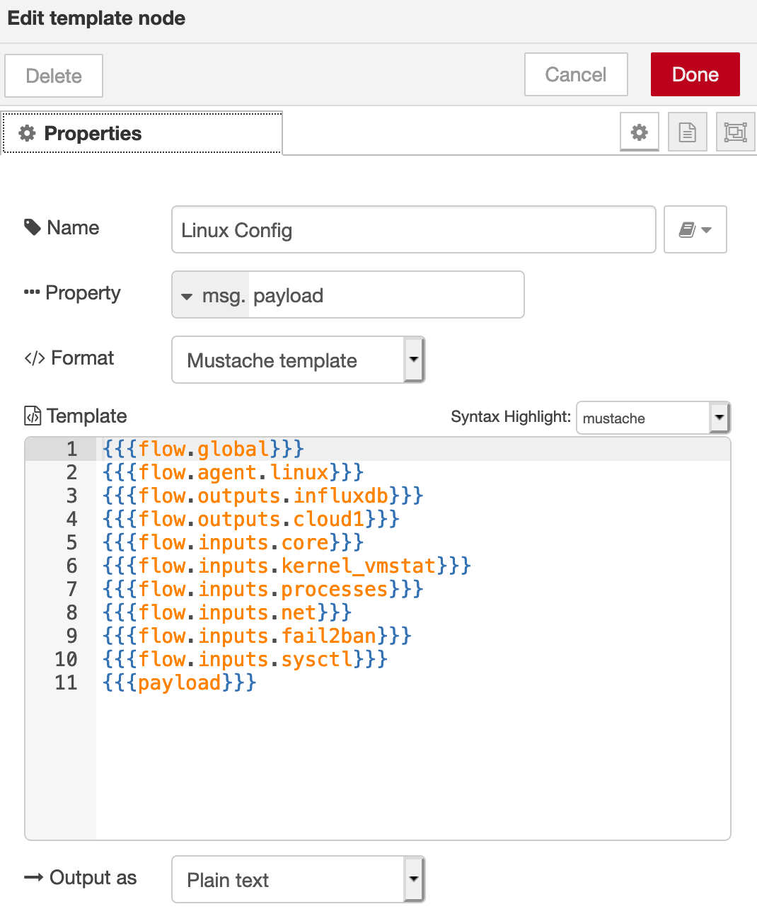

That config contains my ActiveMQ and Jolokia-2 config information (I use ActiveMQ as my MQTT broker because it has monitoring hooks and a built-in view of all the topics I’m using, along with an indication of how many subscribers I have listening to each topic). The workflow then goes to the Linux config node, which inserts all the standard Linux monitoring configs I want to use, appending the MQTT config at the end:
The final step is a “http-out” node, which responds to the original requestor with the required config data.

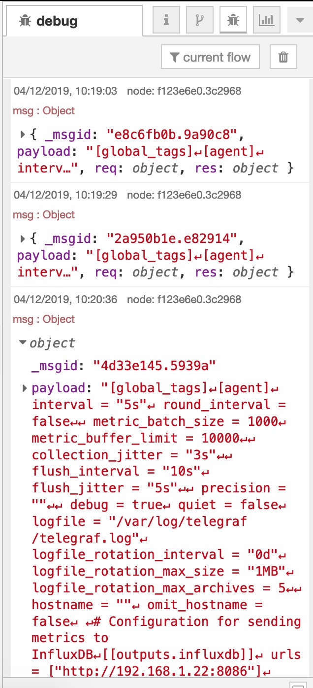

Every few minutes, Node-Red logs that a connection has been made and a new config has been served:

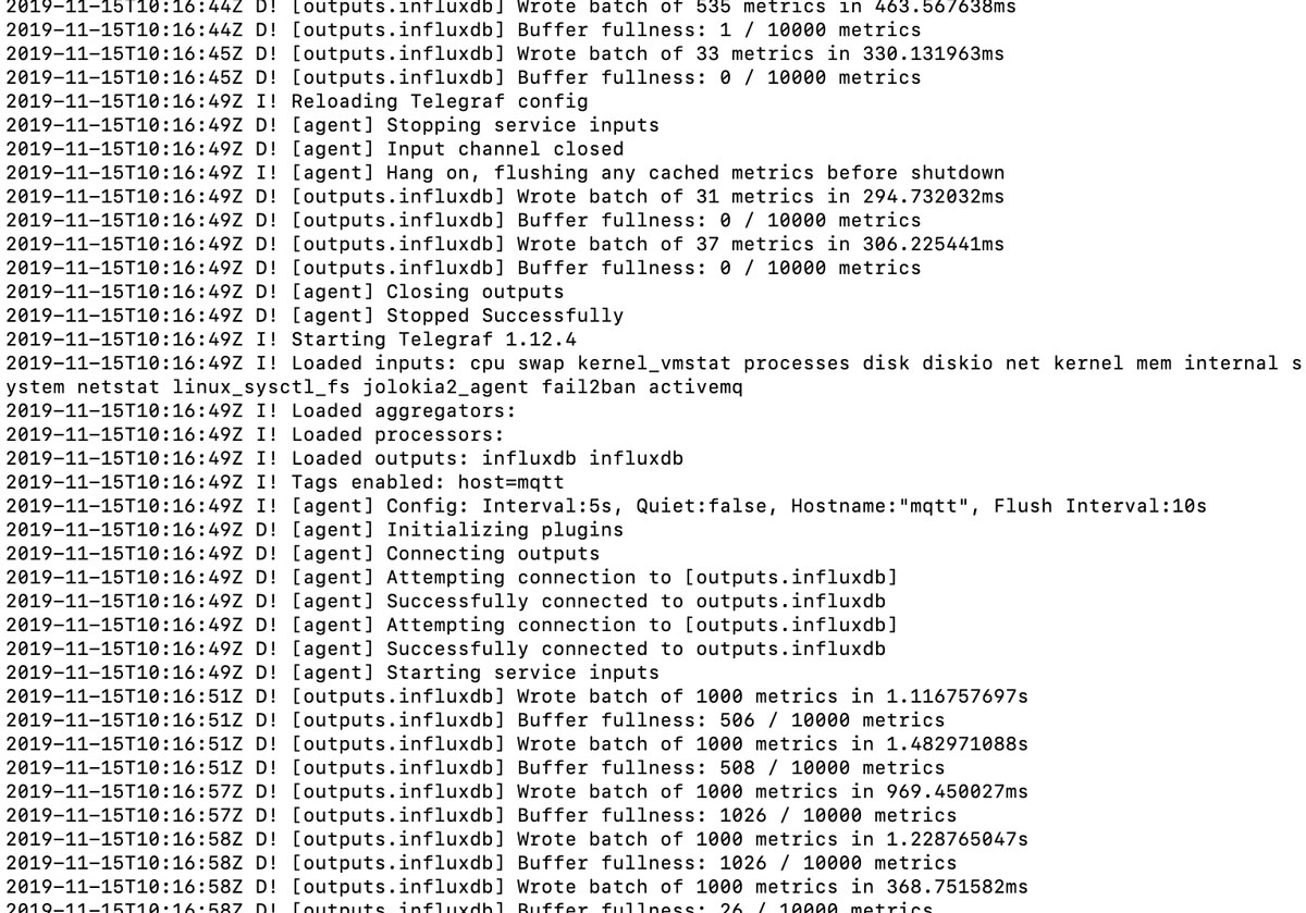

How does this look from the Telegraf end? Here’s a section of telegraf.log from the server named “mqtt”, which shows what happens when the reload command is sent to Telegraf, how it writes all buffered points to InfluxDB before it restarts and loads all its updated inputs and outputs.
Note that the first outputs after the reload contain more points than the outputs before the reload. This is Telegraf processing inputs that were buffered while it was reloading its config. During testing, I noticed that, if I write to the Telegraf instance over HTTP while it’s reloading its config, the HTTP port isn’t open, so this could be a consideration for determining how frequently to reload configs.
