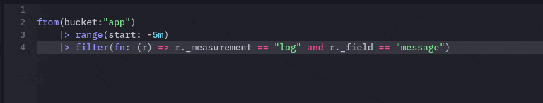

Have you seen this when using the Flux code editor
flux code editor
Pretty neat to be able to get that much help from an editor while writing code.
