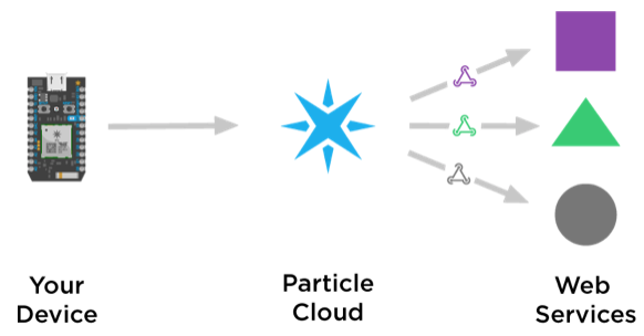

Let’s look at the Particle.io Webhooks first, so we’ll know how to build our Telegraf plugin later. As outlined in their documentation:
SafariScreenSnapz028

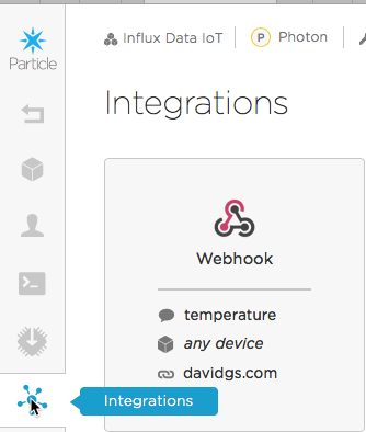

Pretty straightforward, and what we will be building will be one of the ‘Web Services’ shown above. So, off we go to our Particle.io Console to create a new Integration, and choose ‘Webhook’ as the integration type. I’ll be adding this web hook to my existing IoT demo project, so I’ll set the Event Name to ‘temperature’ and for the URL, I’ll use the URL of my Telegraf instance in the cloud.

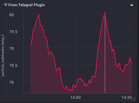

And now, with my custom-built version of Telegraf, and my newly defined Webhook from Particle, my device is sending data to the InfluxDB instance via my Particle Telegraf plugin.
Final Thoughts
This was a surprisingly easy task, other than the debugging of weird behavior thanks to json shenanigans. With some help from a colleague on the GO side, and then a bit of further work, writing the Telegraf plugin took me about a day or so. Ultimately I’d like to expand and generalize it a bit so that it’s not so specific to my needs—have it parse the readings that it is sent, and put them into the database based on other fields in the json—but for now, I have a Particle Telegraf plugin that logs the data I want.
