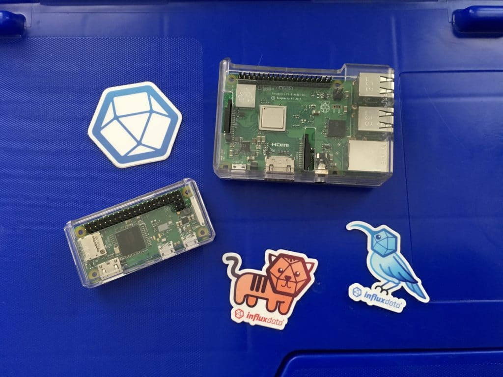

<figcaption> The Raspberry Pi is a great platform for the TICK Stack!</figcaption>
