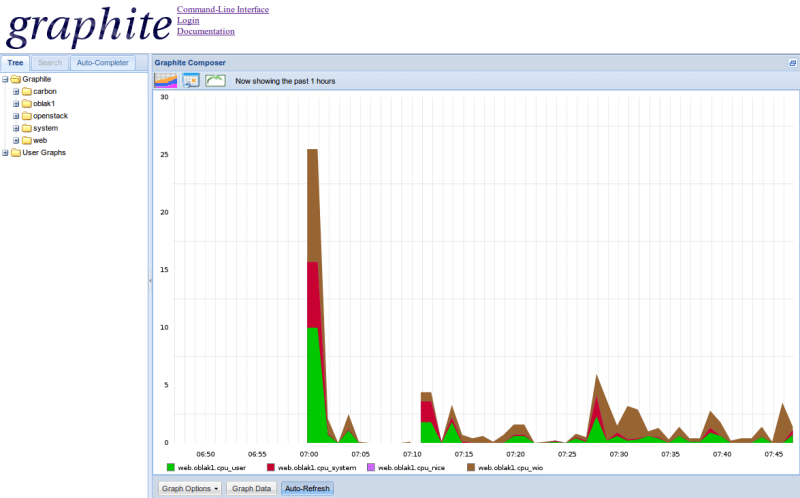

Meet Graphite
graphite

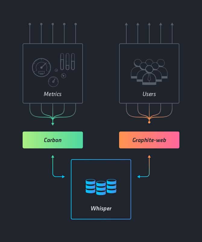

Graphite is a popular, real-time metrics storage and graphing tool written in Python that allows you to store numeric time-series data and graph it on demand. What you do need to bring to the metrics party is some way of sending graphite the data. You can accomplish this with collecting agents like collectd. At a high-level, the architecture of a typical graphite setup consists of three main components:
  • carbon - a daemon that listens to metrics data
  • whisper - a storage library for storing this data
  • graphite web - a web application that renders the graphs on demand
graphite1
A standard graphite setup, where carbon writes metrics into whisper, which stores them for visualizing in graphite-web
This configuration generally works pretty well on a small-scale, where the carbon daemon listens for metrics and reports it to the whisper storage database. But as you reach higher scale say around thousands to millions of metrics per second, add more timelines, and want to aggregate your metrics, you will start hitting the limits of the architecture. You might run into scenarios where carbon just drops metrics because it can’t manage the load thrown at it or cannot manage multiple file handles for the different timelines it has to persist in whisper. So, if you’ve managed to outgrow the limits of this basic setup, what’s next?

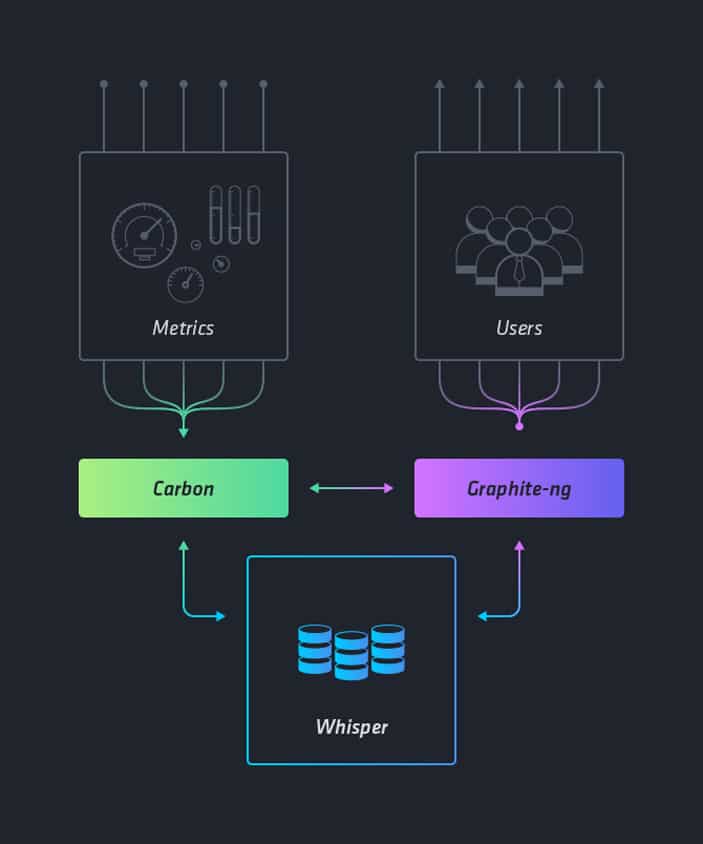

To address some of the scalability problems with the basic graphite infrastructure, Dieter Plaetinck rewrote the graphite server in Go, a language that makes writing concurrent programs easier and more efficient.
Graphite-ng outperforms a vanilla graphite installation and can easily handle millions of metrics per second. As metrics flow into a graphite-ng powered system, it can perform validation of all the incoming data metrics up-front, so you don't have to worry about cleaning up metrics later on the backend. It can also combine multiple metric series, on-the-fly, into a new series, and his functionality allows for faster metrics aggregation as needed.
graphite2
High-level architecture diagram of go written Graphite-ng, and Carbon-relay-ng, with Whisper backend.
It also is worth noting that graphite-ng can be configured to replicate data to multiple backends such as ceres, and elasticsearch, provide redundancy, or partition the data, to balance load.

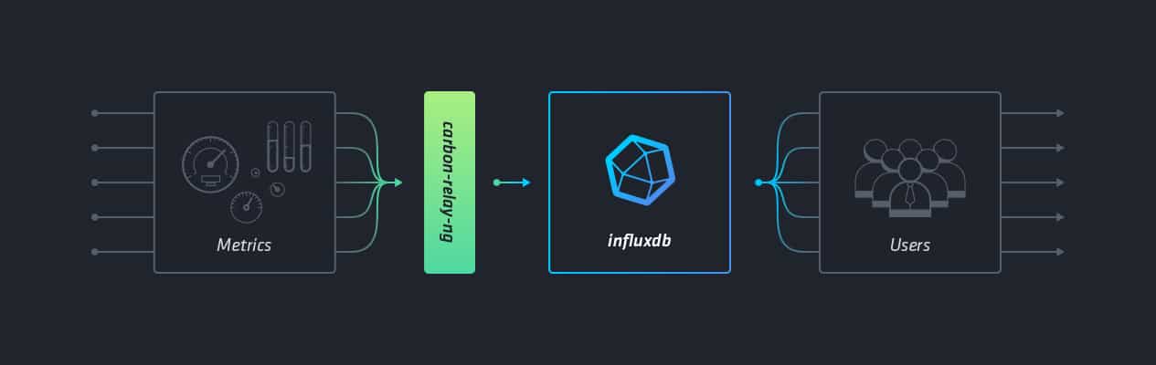

InfluxDB is aiming to solve these problems in the upcoming releases. The 0.8.8 release of InfluxDB used LevelDB as the underlying storage engine, which had better performance than Whisper. Upcoming releases of the 0.9 line are taking lessons from LevelDB and will aim to exceed 0.8's performance on the storage engine side, while bringing in clustering for HA and horizontal scalability.
graphite3
High-level architecture of go based carbon-relay-ng feeding information to InfluxDB
InfluxDB is designed to be simple to install and configure. When clustering support becomes generally available you’ll be able to run a multi-node cluster and replicate your data fully across the nodes for high-availability. Of course, you can get started with testing clustering now, but it’s not yet ready for production use. InfluxDB also provides many ways to write data into it including the line protocol, several client libraries and plugins for common formats like graphite.
