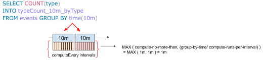

For example, as shown below, if we have a continuous query with group by interval as 10m, compute-runs-per-interval set to 10, and compute-no-more-than set to 1m.
cq_example_1
The query will be computed once per minute and there will be 10 runs in a 10m query interval.
