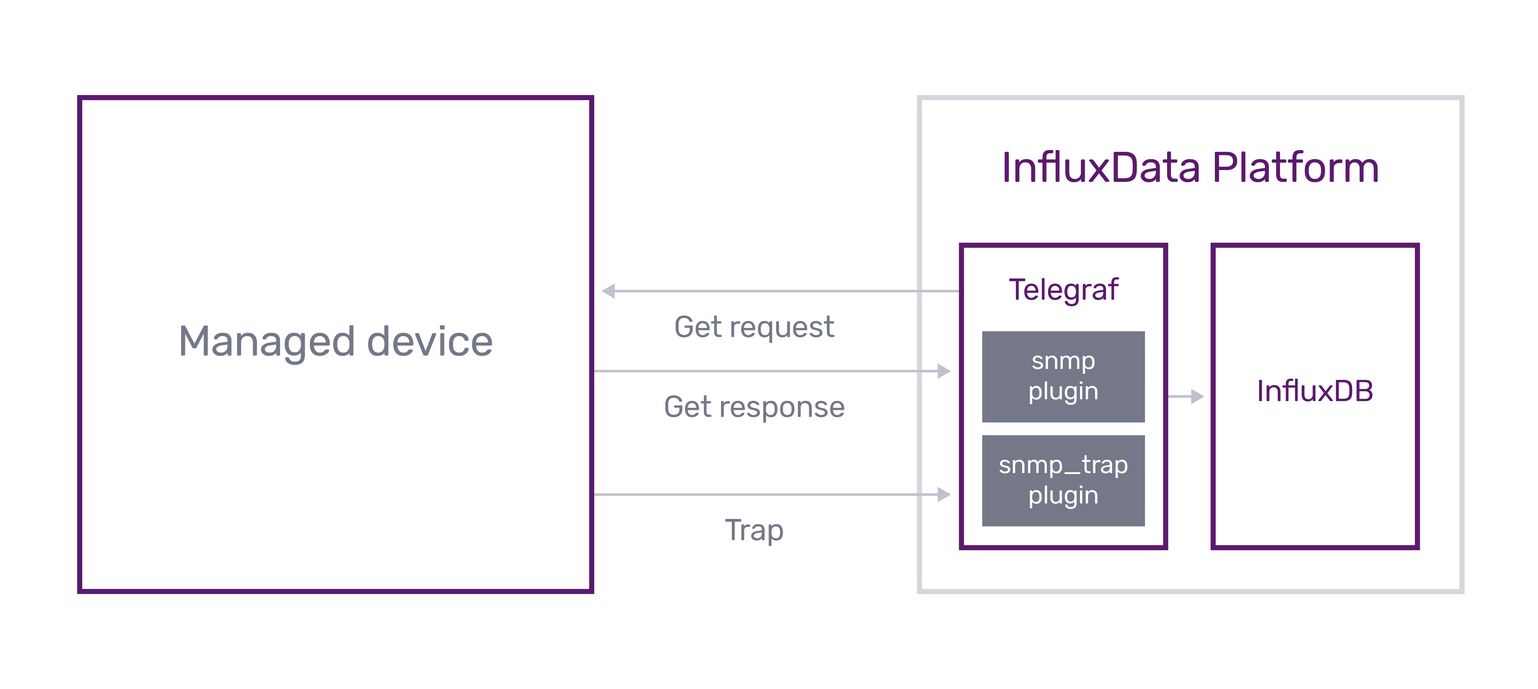

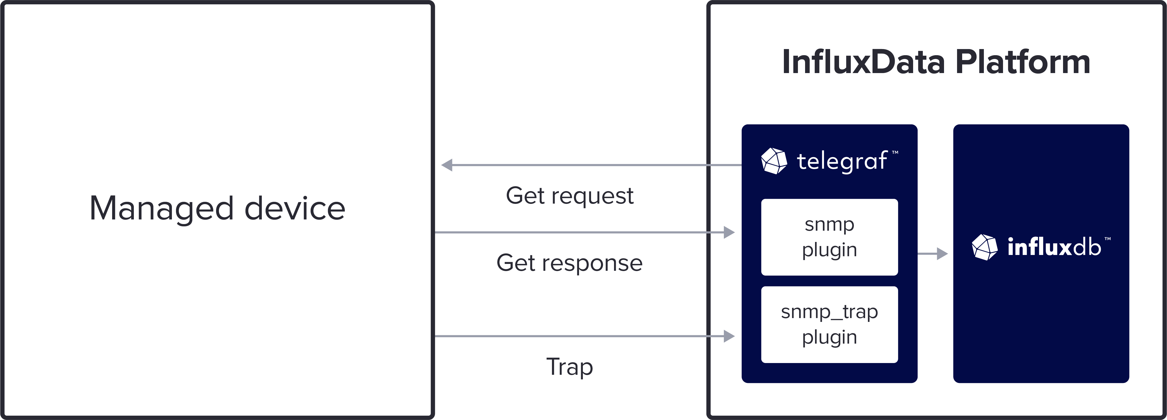

How SNMP Works with Telegraf
Telegraf can be deployed with SNMP Input Plugin configured to poll specific OIDs. Telegraf then batches the data and streams it to InfluxDB.
When you use the Telegraf SNMP Trap Input Plugin, your Telegraf deployment will begin to receive SNMP notifications pertaining to all traps and inform requests, thus giving you a real-time view of your system and network performance issues.
By continuing to monitor these SNMP notifications on a regular basis, you can balance resource consumption impact and thus mitigate risk from challenges rather than allowing yourself to be surprised by them.
If you were suddenly dealing with an issue where a critical power supply unit failed, for example, the Telegraf SNMP Trap Input Plugin would allow you to get a notification about it immediately. More than that, Telegraf will send that SNMP trap to the output plugins to further notify your team members that something is going on so that they can quickly take steps to correct it.
