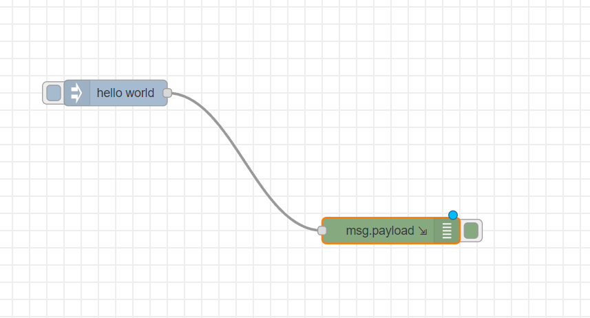

Once Node-RED is installed you can open your web browser and visit localhost at port 1880 and see the Node-Red editor. We’ll start out making a basic “hello world” flow to confirm everything is working properly.

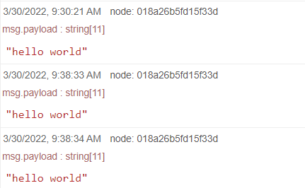

First, drag an inject node from the left hand sidebar and put it onto the editor. Click on the node and change the payload to a string with value and whatever input you want, I’ll follow tradition and use “hello world” for my value.
Now grab a debug node and place it on the editor, by default it will output the message payload passed by the previous node. Click on the debug node and check the box for “system console” so our message will also be printed to the terminal as well as the debug sidebar. Your editor should look something like this:
Now you can click deploy in the top right corner of the Node-Red editor. Click the box on the left side of your inject node to start your flow. If everything worked properly you should see values appearing in both your terminal and the Node-Red debug sidebar:

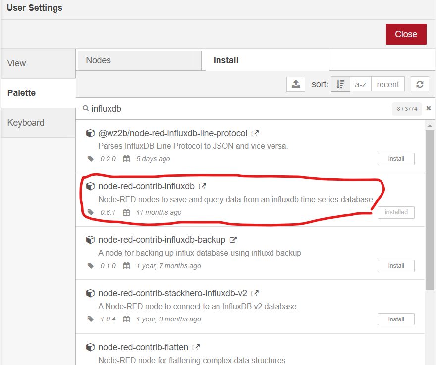

The first thing you need to do is install the InfluxDB Node-Red package. To do this click on the hamburger menu icon on the top right of the editor next to the deploy button. Then click on ‘manage palette’ and then click to the Install tab. Type InfluxDB into the search box and select the package called node-red-contrib-influxdb.
With that package installed if you scroll to the bottom of your node palette on the left hand of your screen you should see three new nodes added for working with InfluxDB.

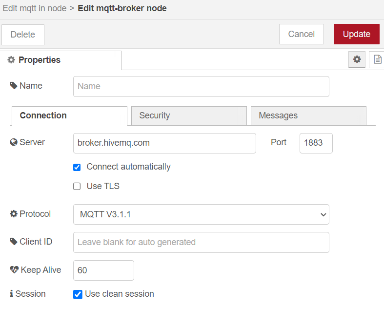

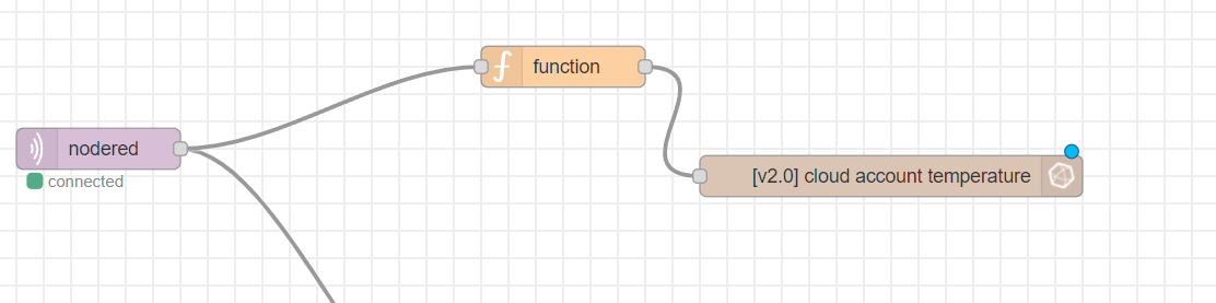

For this flow instead of using an inject node to start things, we will use the MQTT In
node and connect to a free public MQTT broker provided by HiveMQ. If you already have an MQTT broker installed locally you can also use that, the configuration is the same. Click on the MQTT node after dragging it onto the editor and add a new broker by providing the server URL and port number. For HiveMQ the URL is broker.hivemq.com
and the port is 1883
. Leave the version as MQTT V3.1.1.
Set the Action
for the node to subscribe to a single topic and put in the topic you want to listen to, it can be whatever you want in this case. I’ll be setting the topic as nodered
for simplicity. Once you deploy this flow, Node-RED will connect to the broker and listen to any messages under that topic name.
We will be passing a temperature number through MQTT to simulate some sort of IoT sensor recording air temperature. By default this will be passed as a string, so we need to create a function to convert it into an integer before storing it with InfluxDB. Add a function node to the page and put the following code into the node:
msg.payload = Number(msg.payload)
return msg;
Now add the InfluxDB Out
node and connect it to the function. Create an InfluxDB server instance by adding in your URL and API token. Then add in your organization ID and the name of the bucket where you want to store your data.

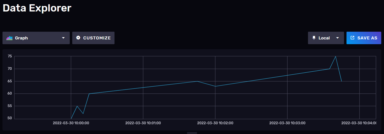

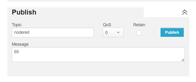

To test everything out you can use any MQTT client, HiveMQ also provides a websocket client that is easy to use here. Set the topic to match the topic in your MQTT node and then publish a message with a number as the value, something like this:
If everything worked properly you should start seeing data in your InfluxDB instance every time you submit an MQTT message to the broker:
The flow itself should look similar to this, note the MQTT node provides a notification box letting you know if you are able to connect to the broker:
