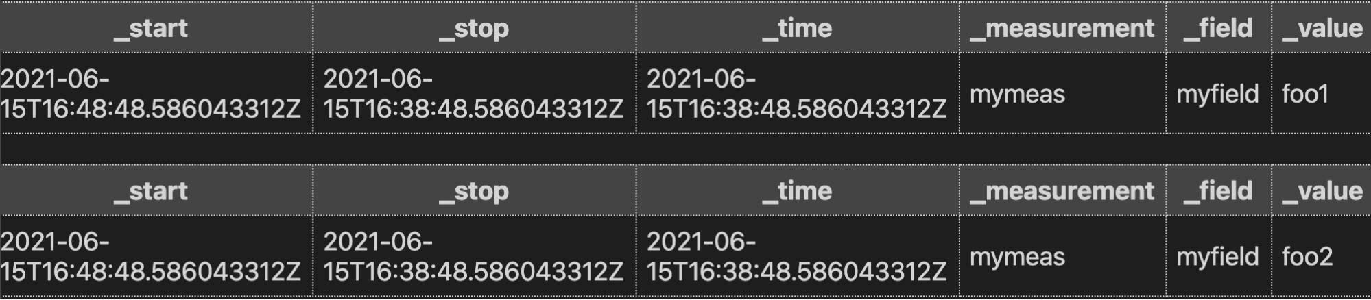

bucket1 = array.from(rows: [{_start: start, _stop: now(), _time: now(),_measurement: "mymeas", _field: "myfield", _value: "foo1"}])
|> yield(name: "bucket1")
bucket2 = array.from(rows: [{_start: start, _stop: now(), _time: now(),_measurement: "mymeas", _field: "myfield", _value: "foo2"}])
|> yield(name: "bucket2")
The annotated CSV output from our query looks like this:

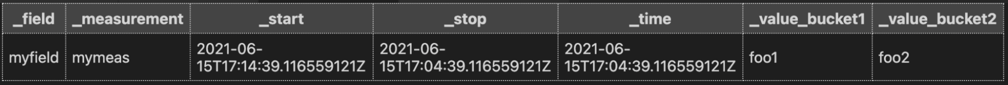

Don’t use drop() unnecessarily after a join():
join(tables: {bucket1: bucket1, bucket2: bucket2}, on: ["_time"], method: "inner")
|> drop(columns:["_start_field1", "_stop_field1", "_measurement_field1", "myfield1"])
|> yield(name: "bad_join")
Do replace with changes to the group key by joining on like-columns:
join(tables: {bucket1: bucket1, bucket2: bucket2}, on: ["_start","_stop""_time", "_measurement","_field"], method: "inner")
|> yield(name: "good_join")
To yield the same result:

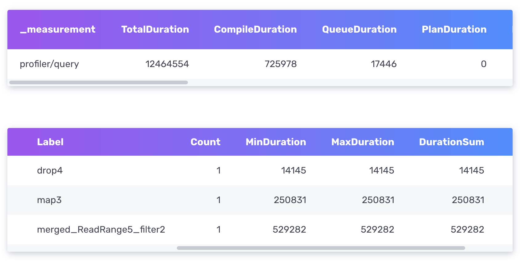

Yields the following tables from the Profiler:
The Flux Profiler outputs performance information about your query in nanoseconds.
- The first table provides information about your entire query including the total duration time it took to execute the query as well as the time it spent compiling, in the queue, etc.
- The second table provides information about where the query is spending the most amount of time.
The two most important columns to pay attention to are the TotalDuration column from the first table and the DurationSum column from the second table. This query is executed very quickly, so I don’t have to worry about optimizing it. However, I’ll describe the thought process for optimizing it further.
First I would try to identify which part of the query is taking the longest to execute. From the query above, we can see that the merged_ReadRange5_filter operation has the largest DurationSum of 529282 ns. If I was planning to convert this query to a task and perform this transformation work on a schedule, the first thing I should consider is querying data over a shorter range and running the task more frequently.
Next, I notice that the map() function contributes the second longest DurationSum value. Taking a look back at my map() function, I have to wonder if renaming the measurement with map() is the most efficient way. Perhaps I should try using the set() function instead like so:

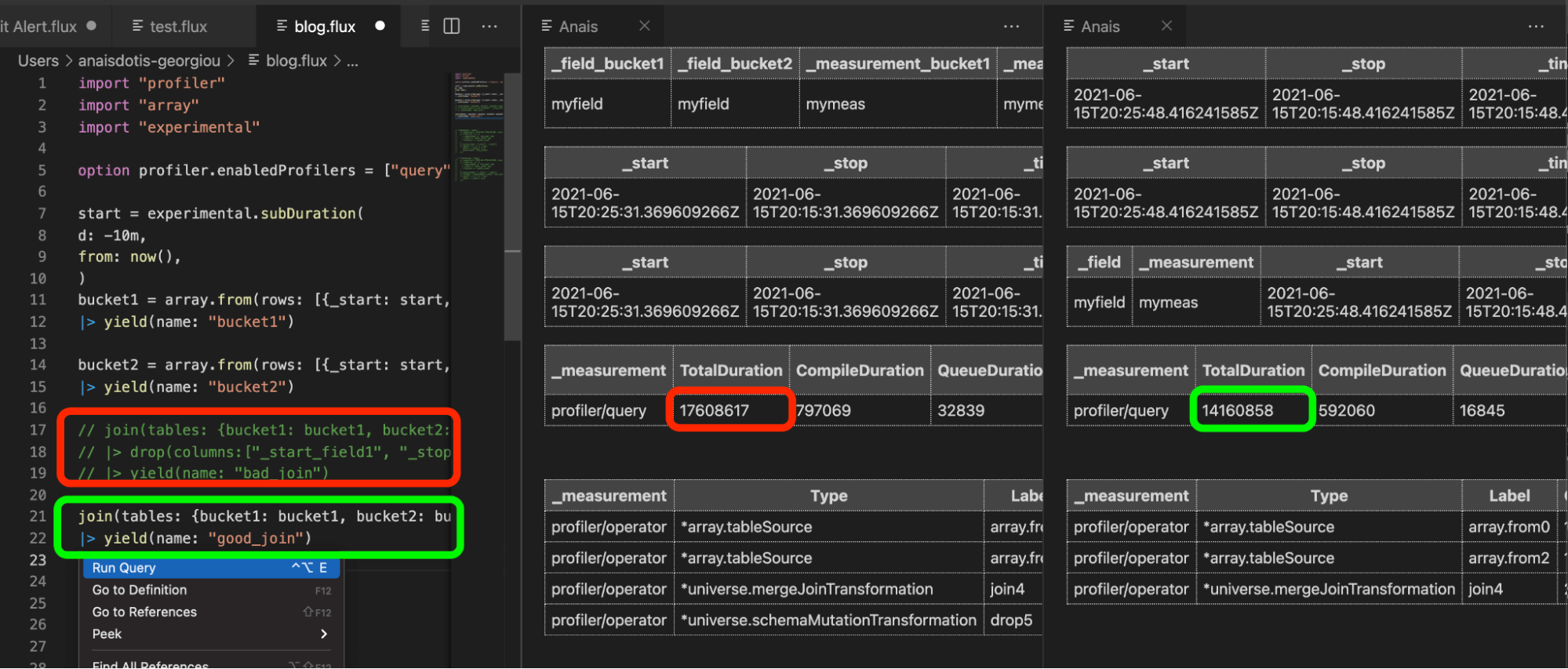

Using the Flux extension for Visual Studio Code to streamline Flux optimization discovery
If you haven’t given it a try already, I encourage you to install the Flux extension for Visual Studio Code. To query your InfluxDB Cloud account with the Flux extension, you must first configure it and connect to your cloud account. I enjoy using the Flux extension and VS Code when trying to debug complicated Flux scripts or trying to optimize the performance of my Flux scripts because I can save my Flux scripts and compare outputs from the Profiler simultaneously.
<figcaption> The original “bad_join” query (red) is commented out because I ran it first. Its TotalDuration time was 17608617 ns. Joining on multiple like-columns and removing the drop() improves the performance to 14160858 ns.</figcaption>
I decided to test the queries described in the “Using schema mutations properly” section above. The Profiler confirms my hypothesis: joining on multiple like-columns is more efficient than dropping redundant ones retroactively. While you can also perform this work in the InfluxDB UI, I find the side-by-side comparison of Profiler outputs helpful for this type of experimentation.
