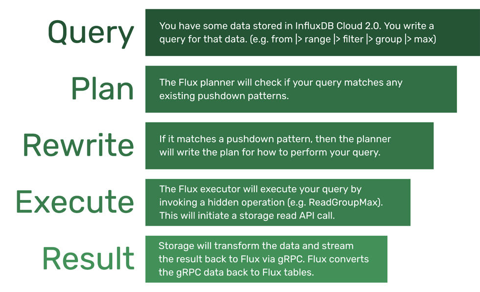

For any of you advanced Flux users wanting more detail about how Flux operates, the image below is a visualization of the way that Flux executes a query. First, you write a query, then the Flux planner checks if your query matches existing pushdown patterns. If there’s a match, the planner writes a plan for how to perform your query. Next, the Flux executor executes your query by invoking hidden operations that initiate a storage read API call. These hidden operations differ based on your pushdown pattern. For example, if we execute a query with from |>range() |> filter() |>group() |>max(), a corresponding hidden storage operation, called ReadGroupMax, initiates data transformation on the storage side. The data is then streamed back to Flux via gRPC where Flux can then convert the data to Flux tables, or Annotated CSV.
<figcaption> A visualization of the way Flux executes a query. If a query matches a pushdown pattern, then storage executes the data transformation with the help of hidden storage operations (pushdown patterns have corresponding hidden storage operations). gRPC is used to stream data from storage back to Flux.</figcaption>

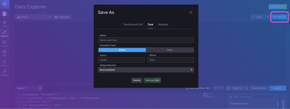

If you’ve read any of my other posts, you know that I truly believe the InfluxDB UI is your best friend when it comes to learning how to write Flux. Learning how to craft tasks is no exception. After you’ve crafted your task in the Data Explorer, use the Save As button in the top right corner to convert your Flux script to a task.
<figcaption> An image of the InfluxDB UI. Use the Save As button to convert your script in the Query Builder or Data Explorer to a task. Configure the name, every, cron and offset options.</figcaption>
